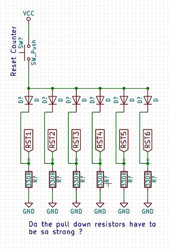

This is a suggestion for forcing a clean reset. The switch could be replaced by a transistor, say an PNP with a 10K pullup resistor. Grounding the base temporarily would force a complete reset.

Then maybe something like:
but subject to testing, maybe in a simulator to get a reasonable value of C1.
good idea, that's a lot of current for reset.
