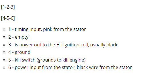

Hi. I want to make a ignition coil driver to play around with. I used the ignition coil with transistor, but it overheats at high frequencies so i thought to use the cdi box. Is there any way to control it by arduino for triggering? It is Ac

Like, for example that pin that says "Timing Trigger"? I'd suggest using that.

It is a 2 stroke magneto CDI unit by the looks of it?
https://www.mopedarmy.com/wiki/Hobbit_CDI_Wiring

AC cdi units like the one you have there require an ac input of several hundred volts.
This is normally supplied by the bike magneto.
Better to go to the dc 12v version.
There is a write up I did in the link below...in there is a pdf (post #19) of all the different cdi units with dagrams etc.
