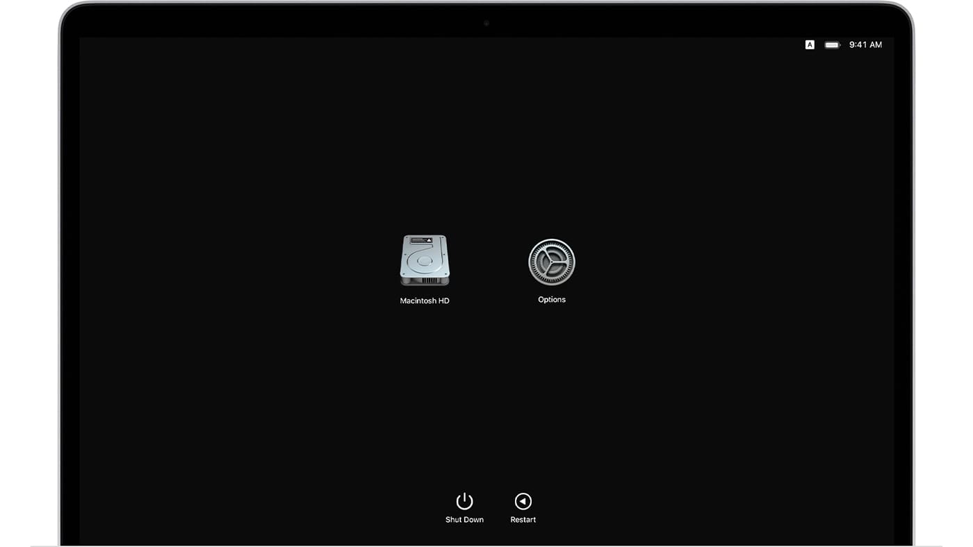

Not sure what happened. You could try to reinstall the OS in recovery mode to go back to a clean OS if something was removed along the way
Macs can operate in macOS Recovery Mode, which allows you to run emergency maintenance on your desktop or laptop. It’s a special mode that loads native recovery tools that help you out when you are in a jam.
Est. reading time: 4 minutes
Make sure you have a full up to date backup…

14
It's a bit too much. I have so many things installed and with custom settings.
J-M-L
October 25, 2022, 1:23pm
15
may be it's part of the issue then....
