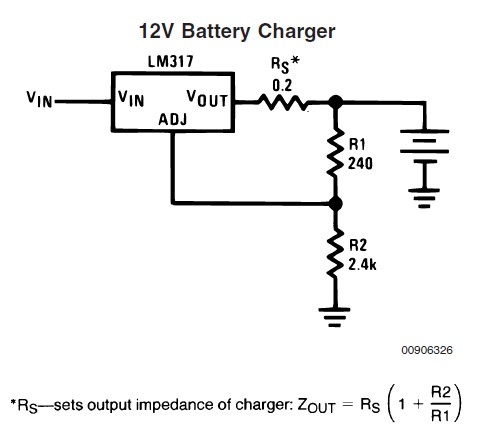

I found this circuit which is very simple way to make a battery charger with an LM317. Not as time-efficient as transistor current-limiting or microcontrol (the output voltage rolls off more slowly, adding to total charge time) but you can't beat the simplicity.
