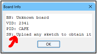

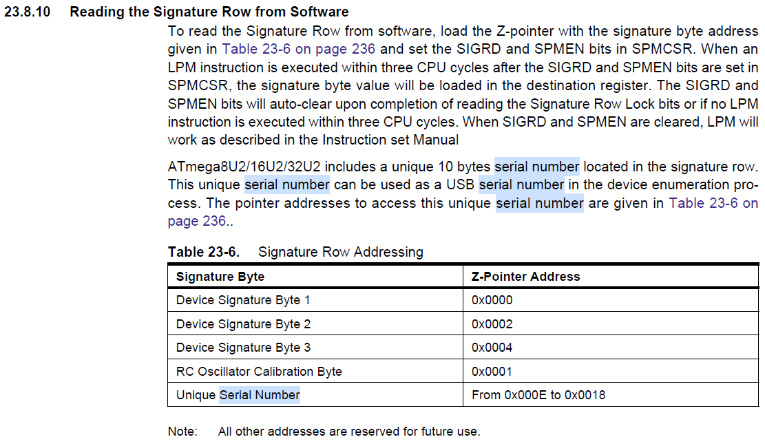

This hints that unique identifiers are not available for the Leonardo's processor.

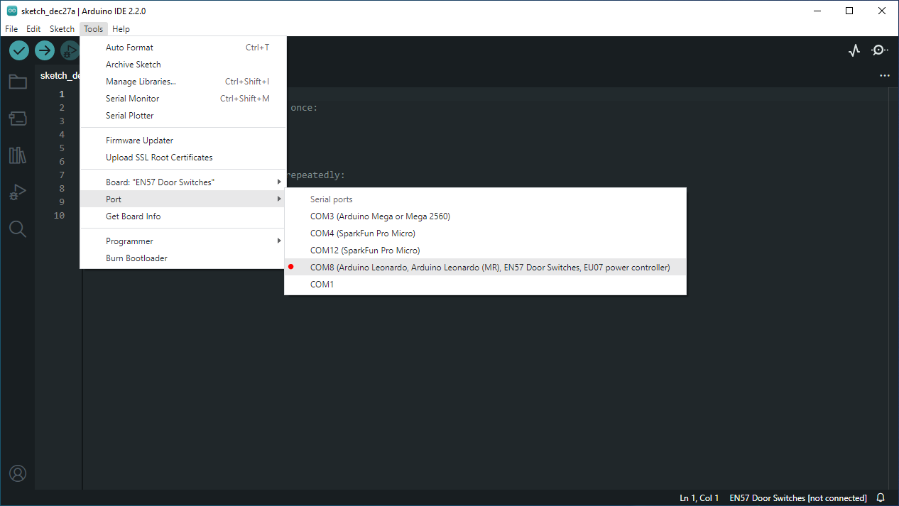

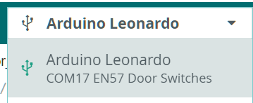

well that didn't work as planned,
but thinking about it, it kinda did work as it should,
I'd changed the 'Friendly name' and 'Display name' in the registry, and also the name of what i thought was the board description for the com port it was on.
All was all ok until i plugged a different controller into a usb port that had previously had a different one in it, and it shows up as the last controller.
the controller in question has a pro-micro in, i named it 'EN57 door switches'
when i unplugged that and plugged in a brand new arduino beetle, originally it was on COM 37,
but once i sent a sketch to it as a Leonardo, it became 'COM 17, EN57 door switches'
So i'm thinking there's something the arduino IDE is doing to assign the COM port number to anything programmed as a Leonardo?
or is it me messing with the registry names and changing the wrong one.

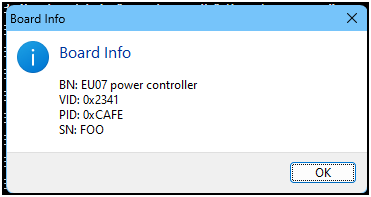

The problem you face is the lack of unique serial number. Without that the operating system cannot differentiate between boards. It's my understanding the Leonardo lacks a serial number.
You can change the ID and serial number with the tool in this document with this URL. Need to make an account. Not try it yet. Must first download and install.

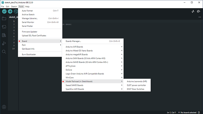

Naming
There are a few things when it comes to naming; in 'boards.txt' (for Arduino's AVR 'boards.txt' file, replace promicro by leonardo).
  1. promicro.name=SparkFun Pro Micro; this sets the name that the IDE displays in the status bar as well as for the ports.
  2. promicro.build.variant=promicro will be used in the name of a hex file when you use sketch / export compiled binary in the IDE; it has more purposes.
  3. promicro.build.usb_product="SparkFun Pro Micro"; this is the name that is programmed into the board and will show in Control Panel / Devices and Printers.
  4. The name that you see in the Device Manager is, to my knowledge, determined by the driver.
Solution
There are two functionalities regarding this solution. The first one is to program the board with the usb_description so it can be recognised as a specific board; the second one is a dedicated powershell script that can detect that usb_product and determine the upload port based on that.

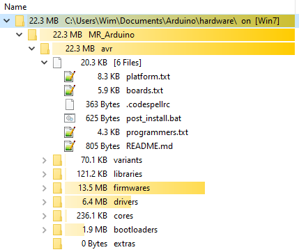

Modifying 'boards.txt'
Edit 'boards.txt'.
For each specific board, make a copy of the 'leonardo' entry
Edit the entry according to needs so it looks like below; please note that the below is based on sparkfun's AVR board package and the vid/pid and build variant differ

  1. Each of your boards needs a unique identifier in 'boards.txt'. In the above example, it is EN57; for the power controller I used EU07.
  2. EN57.name=EN57 Door Switches is used by the IDE to show the name of the board in the status bar.
  3. EN57.build.usb_product="EN57_Door_Switches" is used by the verify (compile) process and eventually ends up in the HEX code after a compile. For the powershell upload script to work correktly, this needs to be the name of the sketch.
  4. EN57.build.variant=promicro is (amongs other things) used to create the file name of the hex file.
Restart the IDE.
After restarting the IDE, you should have new entries for your boards; select the correct one based on the needs.
As said, I'm using the SparkFun AVR board package. I have also stripped the board package down to the bare minimum needed for Sparkfun Pro Micro boards (hence only three entries).

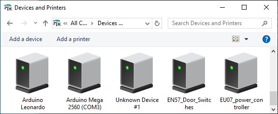

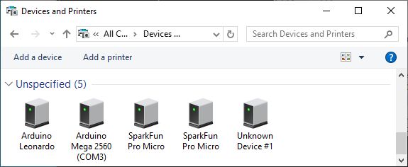

Uploading
Your first upload to any of the boards needs to be done using the IDE; you can use e.g. the BareMinimum example or your code; just make sure that you use the correct port. In this way, the boards will get their usb_product.
Before the upload, 'Devices and Printers' on my system looks like
After the two uploads from the IDE, 'Devices and Printers' on my system looks like
You can use the upload script from the command line like powershell -file upload.ps1 EU07_power_controller or powershell -file upload.ps1 EN57_Door_Switches

Retrieve list of com ports
The script retrieves a list of ports using Get-PnpDevice; this list of ports will not contain serial-to-usb converters but that is not relevant for the intended purpose.
The result (based on the FriendlyName)
SparkFun Pro Micro (COM4)
Arduino Mega 2560 (COM3)
SparkFun Pro Micro (COM12)
Arduino Leonardo (COM8)
Parse com ports and get usb_description
The script loops through the list of com ports and parses them using a regular expression to extract the port. It will use this port later to reset the board.
Next it extracts the usb_description (DEVPKEY_Device_BusReportedDeviceDesc) based on the vid/pid (instanceId) using Get-PnpDeviceProperty.
Upload
If it finds a matching usb_description, it will start the upload; it resets the board using the com port, gets a new list of devices and tried to find one (using a regular expression) that contains the word 'bootloader'.
If found, it starts the upload on the com port that was extracted using the regular expression.
Example output

COM4      SparkFun Pro Micro            EN57_Door_Switches
No match for 'EU07_power_controller' on 'COM4'
COM3      Arduino Mega 2560
No match for 'EU07_power_controller' on 'COM3'
COM12     SparkFun Pro Micro            EU07_power_controller

Preparation
  1. Create a directory 'hardware' (lowercase) in your sketchbook directory if it does not already exist.
  2. In the hardware directory, create a directory with your username (e.g. 'gazz292'). This directory officially indicates who the maintainer is (e.g. Arduino, SparkFun etc) of the board packages in the directories underneath it.
  3. Create a directory with a name that reflects the purpose of the board package. I called it 'MR_AVR_ARDUINO' indicating Model Railroad, avr based boards from Arduino; if you later decide to use other boards, you can create a similar named directory.
  4. Copy the original board package to 'hardware\gazz292\MR_AVR_ARDUINO. For a stabndard IDE installation, the files and directories of interest are in
    'C:\Users\Wim\AppData\Local\Arduino15\packages\arduino\hardware\avr\1.8.6'.
If you now (re)start the IDE, you will have two entries for the Arduino AVR boards in 'Tools / Board'; the original one 'Arduino AVR Boards' and the new one ''Arduino AVR Boards (in Sketchbook)'.
Hacking the board package
  1. Change the name of the board package.
    • Open the file 'hardware\gazz292\MR_AVR_ARDUINO\platform.txt' in a text editor.
    • Change the name of the package by changing name=Arduino AVR Boards to e.g. name=Model Railroad; this will reflect in the IDE
    • Change the version in a similar way if desired.
    • Save the file.
  2. Add / remove boards.
    • Open the file 'hardware\gazz292\MR_AVR_ARDUINO\boards.txt' in a text editor.
    • In the attached file, I have removed all boards except for the Leonardo as that is what you were using.
    • Changeleonardo.name=Arduino Leonardo to e.g. leonardo.name=Arduino Leonardo (MR);this is not strictly necessary.
    • Change leonardo.build.usb_product="Arduino Leonardo" to e.g. leonardo.build.usb_product="Arduino Leonardo (MR)"; again not strictlu necessary.
    • Add new boards as already described in earlier post.
    • Save the file.
Attached the board package; you can extract it and copy the full 'MR_AVR_ARDUINO' directory to 'hardware\gazz292'.
MR_AVR_Arduino.zip (7.8 MB)

Differentiation of the platform from other platforms of the architecture should be done exclusively via the "vendor" folder's name.
@ptillisch, thanks
I will adjust. It will mean a vendor name like Arduino (MR) instead of gazz292 and renaming the MR_AVR_ARDUINO back to avr. And a vendor like SparkFun (MR).
And while you're here (:wink:), it might be clear that there is a need to be able to identify a board (with native USB) in the ports menu based on some unique parameter. I understand that this will require an update (feature request) of the serial-discovery tool; will it also require an update (feature request) for the IDE / CLI?
@gazz292 attached updated version. Only tested by compiling. I've made a small change in platform.txt (name=Model Railroad (Arduino))
  1. Delete 'hardware/gazz292'.
  2. Unzip attached file and place it in 'hardware/'.
MR_Arduino.zip (7.8 MB)
The hardware tree should now look like

I was able to set an arbitrary serial number by modifying the core as described here:
--- a/MR_AVR_Arduino/avr/boards.txt
+++ b/MR_AVR_Arduino/avr/boards.txt
@@ -60,22 +60,7 @@ leonardo.build.extra_flags={build.usb_flags}
 EU07_power_controller.name=EU07 power controller
-EU07_power_controller.vid.0=0x2341
-EU07_power_controller.pid.0=0x0036
-EU07_power_controller.vid.1=0x2341
-EU07_power_controller.pid.1=0x8036
-EU07_power_controller.vid.2=0x2A03
-EU07_power_controller.pid.2=0x0036
-EU07_power_controller.vid.3=0x2A03
-EU07_power_controller.pid.3=0x8036
-EU07_power_controller.upload_port.0.vid=0x2341
-EU07_power_controller.upload_port.0.pid=0x0036
-EU07_power_controller.upload_port.1.vid=0x2341
-EU07_power_controller.upload_port.1.pid=0x8036
-EU07_power_controller.upload_port.2.vid=0x2A03
-EU07_power_controller.upload_port.2.pid=0x0036
-EU07_power_controller.upload_port.3.vid=0x2A03
-EU07_power_controller.upload_port.3.pid=0x8036
+EU07_power_controller.upload_port.0.serialNumber=FOO
 EU07_power_controller.upload_port.4.board=leonardo
 EU07_power_controller.upload.tool=avrdude
@@ -101,8 +86,9 @@ EU07_power_controller.bootloader.lock_bits=0x2F
 EU07_power_controller.build.mcu=atmega32u4
 EU07_power_controller.build.f_cpu=16000000L
 EU07_power_controller.build.vid=0x2341
-EU07_power_controller.build.pid=0x8036
+EU07_power_controller.build.pid=0xCAFE
 EU07_power_controller.build.usb_product="EU07 power controller (MR)"
+EU07_power_controller.build.usb_serial_number="FOO"
 EU07_power_controller.build.board=AVR_LEONARDO
 EU07_power_controller.build.core=arduino
 EU07_power_controller.build.variant=leonardo
--- a/MR_AVR_Arduino/avr/cores/arduino/USBCore.cpp
+++ b/MR_AVR_Arduino/avr/cores/arduino/USBCore.cpp
@@ -542,9 +542,13 @@ bool SendDescriptor(USBSetup& setup)
 		else if (setup.wValueL == ISERIAL) {
 #ifdef PLUGGABLE_USB_ENABLED
+#ifdef USB_SERIAL_NUMBER
+			return USB_SendStringDescriptor((uint8_t*)USB_SERIAL_NUMBER, strlen(USB_SERIAL_qNUMBER) + 1, 0);
+#else	// #ifdef USB_SERIAL_NUMBER
 			char name[ISERIAL_MAX_LEN];
 			PluggableUSB().getShortName(name);
 			return USB_SendStringDescriptor((uint8_t*)name, strlen(name), 0);
+#endif	// #ifdef USB_SERIAL_NUMBER
 #endif
--- a/MR_AVR_Arduino/avr/platform.txt
+++ b/MR_AVR_Arduino/avr/platform.txt
@@ -144,4 +144,4 @@ tools.arduino_ota.upload.pattern="{cmd}" -address {upload.port.address} -port {u
 # Default blank usb manufacturer will be filled in at compile time
 # - from numeric vendor ID, set to Unknown otherwise
 build.usb_manufacturer="Unknown"
-build.usb_flags=-DUSB_VID={build.vid} -DUSB_PID={build.pid} '-DUSB_MANUFACTURER={build.usb_manufacturer}' '-DUSB_PRODUCT={build.usb_product}'
+build.usb_flags=-DUSB_VID={build.vid} -DUSB_PID={build.pid} '-DUSB_MANUFACTURER={build.usb_manufacturer}' '-DUSB_PRODUCT={build.usb_product}' '-DUSB_SERIAL_NUMBER={build.usb_serial_number}'
The reason I changed the value of build.pid was to avoid the board also being identified as "Arduino Leonardo". The multiple identifications don't actually cause any problem, so that change is not required, but I thought they might make the demonstration more confusing.
I don't know if there is a better way of configuring an arbitrary serial number.

Maybe I was not clear enough but I did not necessarily imply an additional field in this output
      "address": "COM8",
      "label": "COM8",
      "protocol": "serial",
      "protocolLabel": "Serial Port (USB)",
      "properties": {
        "pid": "0x8036",
        "serialNumber": "",
        "vid": "0x2341"
It's lacking the hardwareId because the the serialNumber is ampty (at least I assume that that is the reason).
The idea was to insert the usb_description (from 'boards.txt') in the serialNumber (and create the hardwareId based on that) if the serialNumber is empty.
I can follow the approach that you took, I will however have to study the changes that you made. I've already gone a few times (in the last week) through the Platform specification - Arduino CLI and will have to do it again to try to figure out what upload.port and build.pid are exactly used for. This will take some time; I can see part of it in the diff output of 'platform.txt'.
I think it would be unexpected behavior. These are two distinctly different things. It would be better to add a new property to the serial-discovery output for this information.
You could use the build.usb_product property instead of build.usb_serial_number in the platform modification I described in my previous reply if you want to set the serial number to that value. I don't know whether the USB framework imposes any restrictions on the serial number value. I notice this:
But I don't know what that number is based on.

I'm reasonably sure that that is the 20 nibbles (10 bytes) of the serial number in the 16U2; they call this an educated guess :slight_smile:

Board identification by arbitrary port properties via the upload_port.<port property ID> system is not supported in Arduino IDE 1.x (unfortunately the developers weren't kind enough to add a note to the platform and pluggable discovery specifications about the tool versions that support the feature). Arduino IDE 1.x uses a short-sighted design that only supports identification via the VID/PID pair (and a completely different but even more limited undocumented system for identifying "network" ports). So it is expected that the port will not be labeled as "EU07 power controller" in the Arduino IDE 1.x Tools > Port menu and in the "BN" field of the Arduino IDE 1.x "Board Info" dialog (Tools > Get Board Info).
What is not expected to me is that the serial number is not shown in the "SN" field of the Arduino IDE 1.x "Board Info" dialog:
I don't have any idea of why it can't recognize it. It works as expected in Arduino IDE 2.x:
An important thing to note is that Arduino IDE (both 1.x and 2.x) does not recognize changes made to the platform configuration files (e.g., boards.txt, platform.txt) while running. So you should restart the IDE after each change to the files to cause it to reload the configurations.
