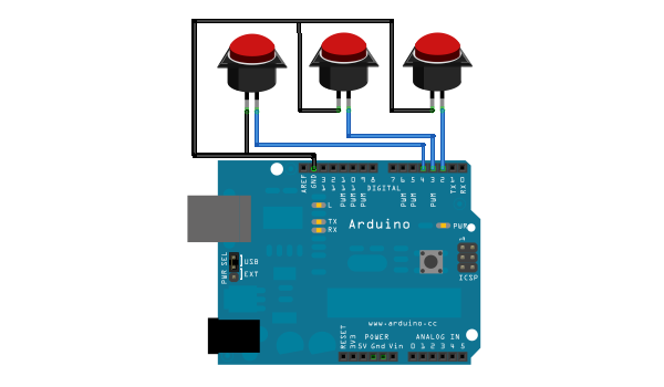

Hello, I would like to ask for help. I need a "widget" that has 4 buttons and a different text is displayed after pressing each of the buttons. Eg: button.1 - Your answer is YES, button.2 - Your answer is NO, etc. - Is this possible? I use Arduino UNO and this display: https://www.aliexpress.com/item/Blue-Display-IIC-I2C-TWI-SP-I-Serial-Interface2004-20X4-Character-LCD-Module/32816049153.html?spm=2114.10010108.1000014.6.45f21ebfZLiwhz&traffic_analysisId=recommend_3035_null_null_null&scm=1007.13338.80878.000000000000000&pvid=88572b51-5b8a-4671-8dc7-1a2a51d167f5&tpp=1.

I tried to do this:

But it does not work :confused: . Can I ask for help? Thank you very much!
What does it do? Were you able to run the example program on the aliexpress page for your LCD?
Answers YES, NO - Appears after "Welcome" without pressing the button. The program from aliexpress works fine. I am sorry for my bad English.
Can I ask for help?
Sure that is what we are here for.
What value pull down resistors are on the push button switch inputs?
At some point in each switch reading code block you need to save the current switch state variables to the previous switch state variables so the previous state is available for the next check.
  lcd.setCursor(0, 0);
  prevSwitchState = switchState;           // ****** save the switch state to previous ******
  switchState = digitalRead(buttonOne);
  if (prevSwitchState != switchState)      // now you can compare what was last loop() to what is now
    if (digitalRead(buttonOne) == HIGH)
      lcd.print("YES");
How are those buttons wired?
Buttons are connected to pins 2, 3 and GND
Do you have external pullup resistors for the switch inputs? I ask because the internal pull ups are not enabled with
pinMode(pin, INPUT_PULLUP);
Buttons are connected according to this diagram
Problem solved :slight_smile: . Here is the function code:

No pull-ups meaning your pins are floating when the buttons are not pressed, and will randomly read high or low. Set you pinMode to INPUT_PULLUP to enable the internal pull-up resistors and likely the problem goes away.
