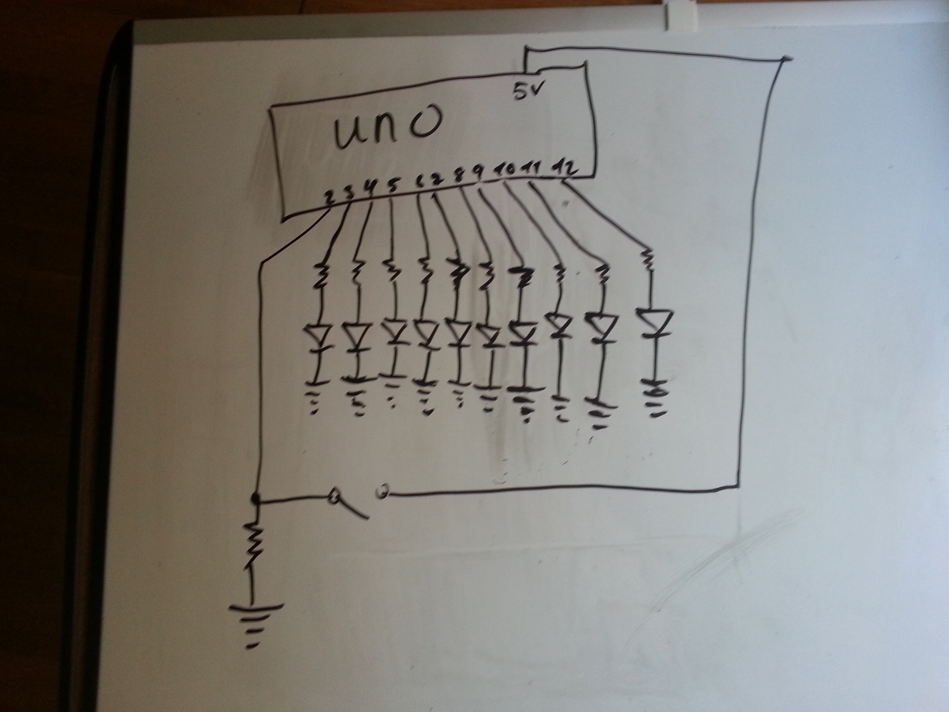

Changing from delay() to "without delay()"
Here i smy code:

The light works but because af all the delay()'s the button don't work.
I have been trying a lot of stuff and searching all over the internet, but can't find anything that I can understand and make work.
In theory i'm doing this:
Light a LED;
wait some time;
Light next LED;
But I'd rather do this:
Light a LED;
come back later when it's time;
Light next LED;
Is it possible??
I have had another tread about this here:
http://forum.arduino.cc/index.php?topic=226331.msg1655620#msg1655620
But I'm not going to get that working and it's beginning to be too messed...
Hi Pady,
I can see that from that thread that Robin2 is helping you with that its hard to get your head around if you are a beginner!
How about this for a "quick & dirty" fix:
void myDelay(long t) {
  for (long i = 0; i<= t && digitalRead(buttonPin) == LOW; i++) {
    delay(1);
Add this function to your sketch and then replace each of your calls to "delay(Time)" with "myDelay(Time)".
All it basically does is break down the long delays into a series of short ones, and checks for the button press before each one. So if the button is pressed, the delay cut short and which ever animation function is running, it finishes in less than the blink of an eye, so your sketch then returns to main() and can check the button properly.
I have not tested that, only checked that it compiles OK. Also you seem to have some strange extra braces in your sketch - "{" & "}" - you might want to double-check, for example in slowonalloff().

@Paul
I have removed a little extra brackets and put in your fix, but it tells me that there are too few arguments??

I have assinged an unsigned long t; in the global variables, so why is'ent it working?
And I love your "Quick N' Dirty" fix, much easier to get my head around :slight_smile:
  readButton();               // call the functions that do the work
  myDelay(); // <-- What's this?
  if (Next == true)
You added an extra call in loop() without a parameter. Take that out and it compiles. You don't need the extra global variable.
But don't Ineed to call it in the loop to use the function outside the loop??
It complies all right and can be uploaded, but all the LED's are lit and are doing nothing.
When I push the button the LED's light up a little more when the button is down...
If you to back to your original code from the first post (with the corrections we spotted) does it work correctly (other than the button not responding)?
Does pin 2 go HIGH when the button is pressed, or low?
Lets see your schematic, or a well-focussed close-up pic.

This works, but with very unstable button.
I have looked a lot on the arduino examples on how to hook up the button and to write the code to that bit..
The pic I added is of the schematic :slight_smile:
I can't spot the problem. The new version of the sketch and schematic both look ok.
Try the new code again with this slight change to myDelay:
  for (long i = 0; i<= t; i++) {
    delay(1);
This should behave just like the old version of the sketch. Does it?
Nope, now the button has no effect at all, can you understand my fustration?? Have been fighting with this a couple of weeks...
I found a few more mistakes. Your readButton() function was never setting Next to true. Also your SlowOnSlowOffReverse() was getting stuck in an infinite loop.
Here you go:

I tested the code you gave me, but the LED's just stood and flickered. But looking at the code made me realize that I had some minor problems, I adjusted them and now the button works but sometimes it swiches when I don't push or switches more than one sequence..
So Now I have a button stabillity problem...
But thanks for the help till now :slight_smile:
And... this is why I wish they would take that "Blink" sketch out of the examples. Teaching us to use delay() to time events first, is like teaching a student driver to brake by using the emergency brake.
Have you taken a look at "Blink Without Delay" and "Debounce" in the Examples?
Pady:
I tested that code, I know it works. Its working right now, on the desk in my study at home. I followed your schematic too, no problems with that. I did not get the problems you describe. You should not have to adjust the code any further...
Can you post a pic of your circuit. I'll post one too this evening.
@PaulRB
Now my code works as well, I think that I have a bad resistor or something like that, so I change to INPUT_PULLUP instead and now it WORKS :slight_smile: I love this thank you SOOOOO much :slight_smile:
One question thou, can you explain what happens in
void myDelay(unsigned long t) {
  for (unsigned long i = 0; i < t && !Next; i++) {
    delay(1);
    readButton();
I adjusted the debounce delay up a bit and it work like a charm :slight_smile:

const int ledPin1 =  3;      // the number of the LED1 pin
const int ledPin2 =  4;      // the number of the LED2 pin
const int ledPin3 =  5;      // the number of the LED3 pin
// Variables will change:
int ledState0 = LOW;             // ledState used to set the LED0
int ledState1 = LOW;             // ledState used to set the LED1
int ledState2 = LOW;             // ledState used to set the LED2
int ledState3 = LOW;             // ledState used to set the LED3
unsigned long previousMillis0 = 0;        // will store last time LED0 was updated
unsigned long previousMillis1 = 0;        // will store last time LED1 was updated
unsigned long previousMillis2 = 0;        // will store last time LED2 was updated
unsigned long previousMillis3 = 0;        // will store last time LED3 was updated
// the follow variables is a long because the time, measured in milliseconds,
// will quickly become a bigger number than can be stored in an int.
unsigned long interval0 = 1000;           // interval at which to blink LED0 (milliseconds)
unsigned long interval1 = 457;           // interval at which to blink LED1 (milliseconds)
unsigned long interval2 = 1020;           // interval at which to blink LED2 (milliseconds)
unsigned long interval3 = 742;           // interval at which to blink LED3 (milliseconds)
  // set the digital pin as output:
  pinMode(ledPin0, OUTPUT);
  pinMode(ledPin1, OUTPUT);
  pinMode(ledPin2, OUTPUT);
  pinMode(ledPin3, OUTPUT);
  // here is where you'd put code that needs to be running all the time.
  // check to see if it's time to blink the LED; that is, if the
  // difference between the current time and last time you blinked
  // the LED is bigger than the interval at which you want to
  // blink the LED.
  // save the current time so it doesn't change during an operation
  // LED0
  if(currentMillis - previousMillis0 > interval0) {
    // save the last time you blinked the LED0
    previousMillis0 = currentMillis;
    // if the LED is off turn it on and vice-versa:
    if (ledState0 == LOW)
      ledState0 = HIGH;
      ledState0 = LOW;
  //LED1
  if(currentMillis - previousMillis1 > interval1) {
    previousMillis1 = currentMillis;
    if (ledState1 == LOW)
      ledState1 = HIGH;
      ledState1 = LOW;
  //LED2
  if(currentMillis - previousMillis2 > interval2) {
    previousMillis2 = currentMillis;
    if (ledState2 == LOW)
      ledState2 = HIGH;
      ledState2 = LOW;
  //LED3
  if(currentMillis - previousMillis3 > interval3) {
    previousMillis3 = currentMillis;
    if (ledState3 == LOW)
      ledState3 = HIGH;
      ledState3 = LOW;
    // set the LEDs with the ledStates of the variable:
    digitalWrite(ledPin0, ledState0);
    digitalWrite(ledPin1, ledState1);
    digitalWrite(ledPin2, ledState2);
    digitalWrite(ledPin3, ledState3);
