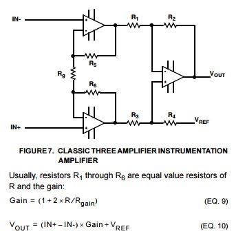

I want to take a linear 5v signal and modify the slope and offset of the signal. For example if I have a pressure sensor that outputs a voltage signal from the following equation:
V_out = 5*(Psi)/58
Where V_out is the signal output, Psi is the sender's absolute pressure reading.
But my display/gauge is expecting an input of:
PSI = 14.5*(V_in) - 7.25
Where PSI is the displayed value, and V_in is the voltage the the gauge sees from the sending unit.
Clearly these are not inverse functions so I will not get an identical mapping from Psi (actual) to PSI (displayed). I know how to algebraically convert one to the other, but I do not know the electronics/components needed to do so.

An op amp.
I can see how this would change the slope (amplification) but I am not sure about how I could change offset. For example add one volt across the board.
an instrument op-amp uses 4 individual op=amps.
one for elevation or zero.
one for span or slope
usually one on the output that is filtered.
This seems like a possible application to follow:
http://www.intersil.com/content/dam/Intersil/documents/an12/an1298.pdf
(starting at figure 7 on page 4) Although figure 4 on page 3 looks to achieve the same end in a simpler fashion.
There is one thing I cannot seem to wrap my head around. From the following Equations...
Gain=(1+2*R/R_gain) ****Means Gain is a Constant
V_out = ([IN+] - [IN-])*Gain + V_ref
Since the Gain appears to be a constant set by precision/high accuracy resistors, it appears that Gain is definitely a constant.
I wanted to be sure of the remaining variable assignments:
[IN+]= input from the signal --- In other words, the 0v-5v linear signal output I want to adjust
[IN-] = signal ground --- The common sensor ground
V_ref=constant for the offset --- some constant (probably VERY small voltage)
V_out = New adjusted signal output, the signal I want my gauge to see.
How can I most accurately/repeatably set V_ref? Voltage divider? Small switching buck converter? Other?
Lastly are there any restrictions on the above that I may have missed? Such as V_ref must be some minimum value compared to [IN+]? or V_out must be less than [IN+]?

It's too easy to do with op amps. You only need two, you can get a dual package like TL081.
aarg:
I do not have the background knowledge to work off of that tip alone. I could probably piece something together, but I will be using the diagram and notes similar to what I posted in post #4. (the ones I posted actually call for instrumentation amplifiers, not that in know the real difference between the two since the diagram symbols are the same...)
I trust you that it probably is too easy to do for you. Skimming the data sheet, I only see extensive application notes for frequency alteration, as well as signal inversion. I did not see any slope+offset applications, such info would make it moderately easy for me.
I realize an op amp is an op amp... but from the documentation I have found, I do not understand enough to use an op amp (or a pair) to achieve what I desire.
Care to share any application notes? :slight_smile:
I suppose this link would make it too easy?
Not sure what a "stable Vref" is in this link. There is no V_ref on the sensor I am reading. Just a ground and a signal that ranges from about 0v to 5v.
