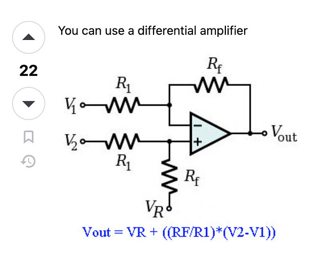

I have a differential analog signal with voltage limits of -4/4 V. My aim is to read the signal via the analog input from the Arduino but I’m struggling with the conversion to single ended input (0 - 5V) (my idea was a differential amplifier).
I’m relatively new to the subject and not entire sure if that’s the right way.

You could use an RS232 receive IC there are many available. Personally, I would use something like an LM358 and connect the signal to each input via two 27K resistors. If your logic is reversed, simply swap the + and - connections to the op-amp. Try this approach and see if it helps. Also, use 5V instead of 12V.
The outputs will not necessarily go to 0 and 5V but it will be within logic threshold levels.

You could use 6 resistors: 2 to create 2.5V aka virtual GND from Arduino, 4 to create two 1:2 voltage dividers and virtual GND on the signal side. Connect both virtual GND and use 2 analog inputs for the divided signals.
I think OP is looking for an an analog signal, mapping a +/-4V differential analog signal into a 0-5V analog signal.
@johnerrington's thread (linked above) has this opamp circuit:
...but it would need a change to move the 0V reference up to 2.5V. Somewhat like this stackexchange circuit:
Per the thread linked above, you need a dual supply to handle the -4V input:
Depending on your requirements for accuracy you may be able to use a solution like this for an AC signal :
You may have to apply a formula to convert the analog value thus obtained to obtain a mapping -4v/+4v to 0v/5v or otherwise interpret the results.

it is an ecg signal, which is amplified by the factor 1mv = 1V and it changes fast

To apply offset for a eeg amplifier I used something like this:
You might want to add a zenenr annd a schottky for protection.
