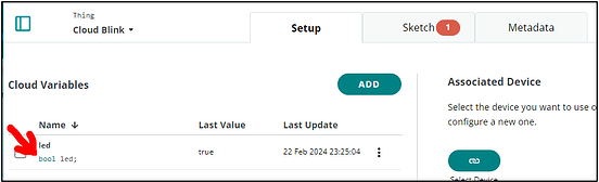

What is the variable type of the power Arduino Cloud Variable in your Thing?
If you don't know, you can find the information by following these instructions:
  1. If you are not already, log in to your Arduino account:
    https://login.arduino.cc/login
  2. Click the following link to open the list of your Arduino Cloud Things in the web browser:
    https://app.arduino.cc/things
  3. Click the name of the Thing.
    The "Setup" page for the Thing will open.
On this page, you will see a list of the variables of your Thing. The type is shown on the line under the variable name. For example, in this Thing I created, you can see that the type of the led Variable is bool:
While the Thing sketch program is running on your board and you are seeing the expected values in Serial Monitor, do you also see the expected values under the "Last Value" column on that Thing setup page?:
