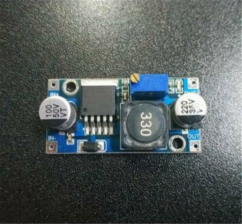

I use this cheap LM2596 "step down" converter module, from 12v to 5v.
With nothing connected, I dial to "5.10" on my multimeter. Each little thing seems to impact the voltage output of this device, a 20ma led for example - like 4 of them can drop voltage BELOW 5 volts. It's still seems to be enough to power a Nano board.
Once I start adding accessories like a wireless module, a Nextion touch screen display - the voltage drops, so much it goes below the NEEDED 5.0v the Nextion requires in order to operate correctly.
Should I be dialing volts on the LM2596 module after everything is running? Because when nothing is connected it would read over 6.5 volts, and at this point is a mystery to me. I think the LM2596 is rated for at least 2 amps, and I'm using just under 900 ma. I was expecting the voltage to possibly drop if I got close to the output maximum of the power module.
I am not married to this device, I am willing to use something else - I am sure there is something better. I chose this because I was under the impression it was more efficient with energy, -vs- lm7805, since the project runs on battery power. I also want to use with 24v battery power, but just learned that the 35v capacitor will not tollerate 24v power for very long.
Many/most SMPS require a minimum load to achieve proper regulation.
You may have to add a resistive load.
Make sure the input voltage is within specifications.

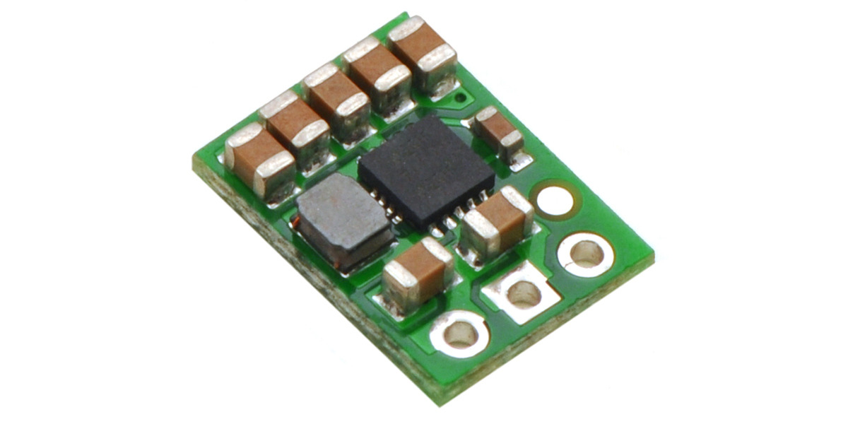

Pololu has good quality regulators:

Ok - this is new to me. Should I be adding a resistor in series with positive output? I just use ohm - law, calcualte 5v * 1 amp, so 5 ohm / 5 watt resistor.
I am not suggesting you will need to draw a large amount of current, just a need some minimum amount.
Try some different scenarios to see if you can effect better regulation, if not, then a better quality/designed board may be necessary.
I also use PS similar if not identical to those and have had no problems, however, the circuits I have used them with are not too sensitive to supply voltages.
I seldom run them at top rated current.
Are you measuring your INPUT voltage when you load the output?
Tom... :slight_smile:
Tom: I am measuring the voltage, on the output pads of the LM2596 module, when I add components to the output 5v supply lines. The input voltage of 12v (and 2.2 amps according to the cheap voltage / current LED monitor) does not appear to change.
larryd: Yes this isn't my first time using the module, I usually just set them at 5v and go on as usual. I have problems with this project, after ping-pong game with Nextion tech-support, they explain the power supply must be 5v in order for device to work correctly. It will work at around 4.9 volts, before I start having problems.
After I discovered this, I went back and started checking voltages and realized how ridiculously sensitive the voltage was to every little 20 ma component added.
I only have a 1n4001 diode on the +5v out line to stop the power from going back up into it where I had a LED power switch. Of course, I am measuring the voltage before and after this diode which is the usual .7v drop, so I dial the LM2596 up to compensate for that.

Just put a 220 resistor across the output or something.
Okay, I just tested four of my similar step down converters, green PCB :wink:
At 12vdc input voltage, I adjusted the output to 5v with no load.
I then added a 1.75 amp load and the voltage fell to 4.98v
These seem to be as advertised.
The LM2596 is a pretty old thingy. If you want to stay in the Aliexpress cheap range (which I think is fine), I would look for the MP1584. Else, Pololu stuff is indeed great.
I would now be doing a A and B check with DMM to see if resistors on the PCBs are the same.
Check that the inductor is properly soldered in.
Find the Vin and Vout of the IC and do a A and B check.
Check the voltage at the feedback pin.
larryd: The "green" boards I see, have TWO potentiometers. Does yours have 2 or 1? Mine has 1.
If this one is broke, is fine I throw away a whole $2.00 or something. But I do not want to buy any more unknowingly, since this is a bigger headache than it's worth.
I think I have some MP1584 in my box of stuff I haven't tested yet - I'll compare that one too.
The poloulu site is interesting, but at $10+ each one - buy 10 at a time is $100 just for little step regulators. Maybe I've been spoiled too much with eBay prices.
