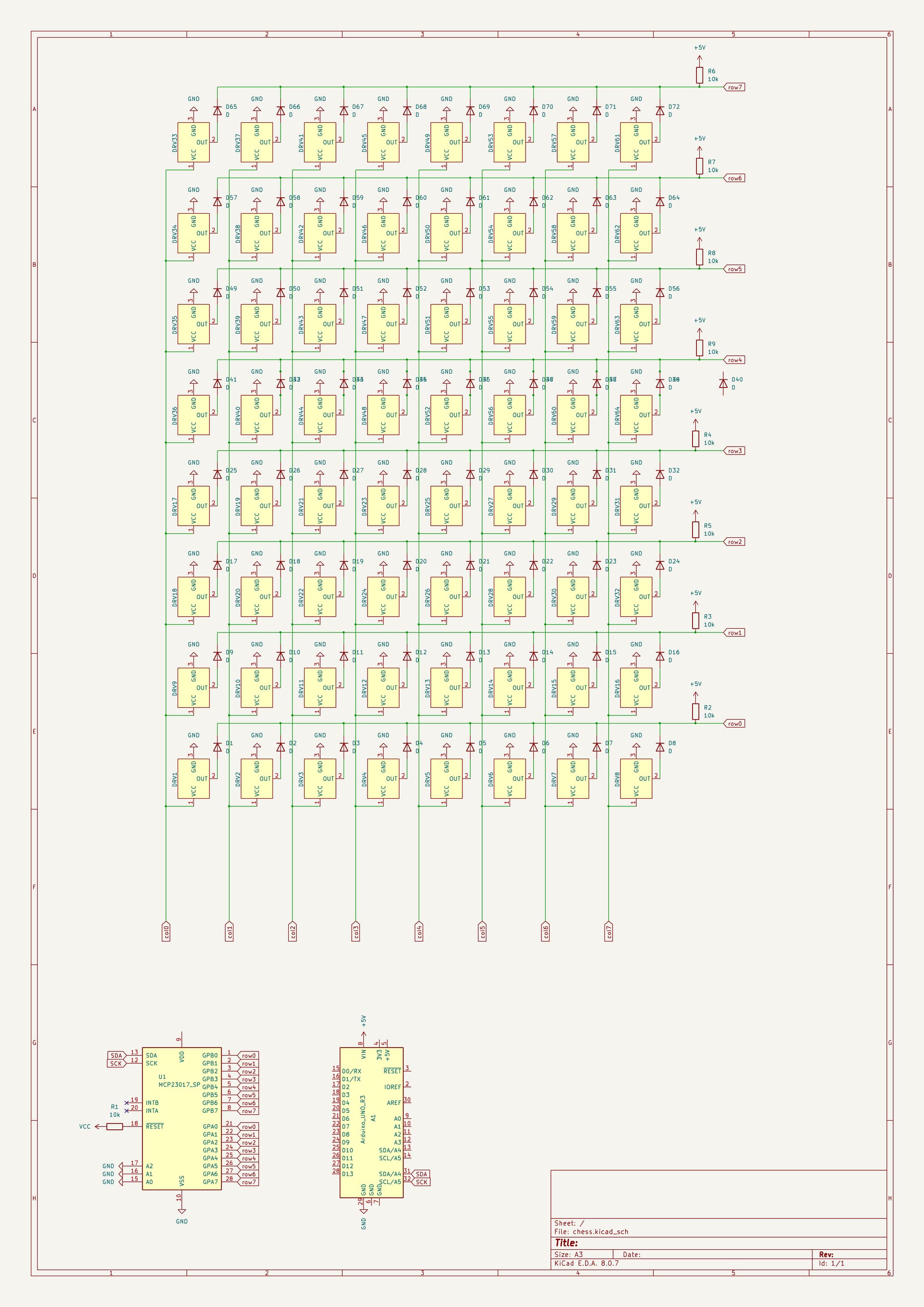

Chess Board Sensor Array Circuit Schematic Help
I am planning to make a digital chess board. The chess pieces will have magnets in the bottom of them that the hall effect sensors should hopefully pickup. The sensors that I am planning to use are DRV5032A hall effect sensors. I have made a schematic in kicad. I am making this post to make sure that I haven't made any silly mistakes

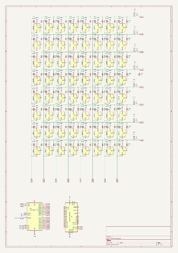

Edit: added diodes
Edit: added caps
I do need diodes
added diodes
Look at the data sheet. See the decoupling capacitor on every driver? Where are yours?
I doubt you can make a matrix with these, but try with two first. A lot depends on what sort of scanning algorithm you will use to drive the matrix.
What sort of package are you using? I would advise using the flat pack.
What sort of size will this be? The sensors might respond to adjacent magnets if it is too small.
Also how do you plan to change the sample rate of the sensors?

Thanks, the board I am intending to make will be similar to this one
The squares are about 33 mm
I have added caps
Also the sampling rate is not changeable see page 5

It is not a matter of putting them everywhere, it is a matter of putting them in the correct place.
See this Tutorial I wrote about this:-
Decoupling tutorial
While I do like a bad pun, I can't say I have much respect for "Nuts and Volts" It seems very amateurish, and has very dogie theory and speculation in their work. Not as bad as "instructables" but not a lot better.
So having read the decoupling tutorial, be if you can spot what was wrong with the decoupling on the LEDs.
