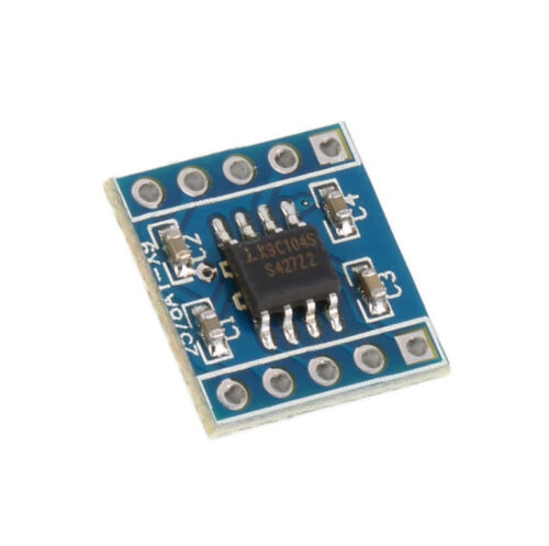

I'd like to float another idea, what if I use a buck step down converter and take out the pot and replace it with say 4 similar external pots set at different levels then use 2N2222 transistors as switches to selectively pick the desired pot hence the voltage.
duinoMike:
Yes you may be able to do that.
Depending on spare pin count you could just have a range of fixed resistors that you can switch in and out
or use a Digital Pot that you can talk to with SPI.
https://www.arduino.cc/en/Tutorial/DigitalPotentiometer
Or similar

I like the idea of switching pots.
Does any one know how the pot is wired in a buck like:
https://www.ebay.com/itm/DC-DC-Adjustable-Buck-Step-down-Converter-Voltage-Module-4V-38V-to-1-25V-36V-New/332923880412?ssPageName=STRK%3AMEBIDX%3AIT&_trksid=p2057872.m2749.l2649
In other words the the portion of a likely circuitry containing the pot. I assume its varying a duty cycle.
I have the same (similar) unit here.
I suspect that the pot maybe part of the feedback circuit.
Will a digital pot work.??
Who knows such things.
Ahh, just buy one or two and see I guess.
