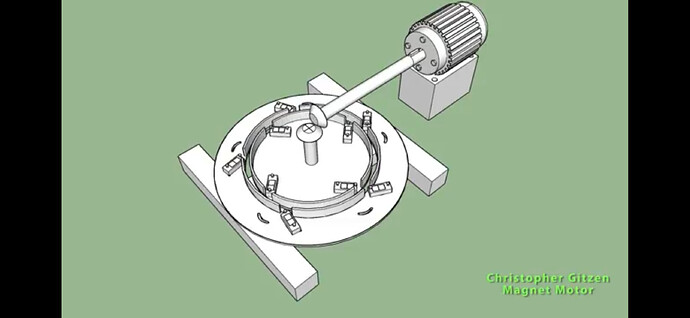

I also got another idea that, when u brought up mumetal, isn’t it also used for shielding what if I made something like this
But without dc motor, since I’ll use superconductors less friction, then at the beginning the train would be started off with the electromagnets and would continue, by being pushed my normal magnets, the mumagnets would be used as a shield, because less coil will be needed, and less voltage, to move the whole train
Are you ever going to measure the force needed to start the train moving?
