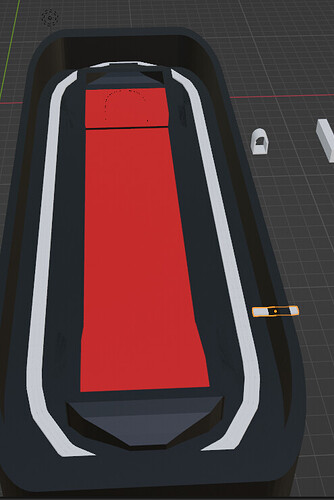

Hello, I want to make a small train that is moved by electromagnets at the side of the train and wanted to ask which electromagnets will be best. It has to be pretty strong enough to propel it forward and can be controlled with an hbridge

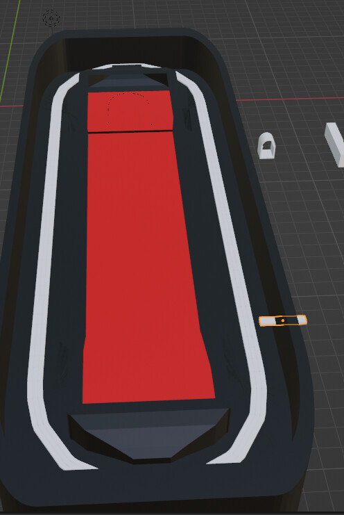

Might be of great help in doing this is to draw the magnetic fields from each magnet in your drawing and estimate the attraction/repulsion when the train is stationary. Your current drawing shows the magnets will only interact at the outer limits of the magnetic fields.

The problem I see here is that electromagnets will have to be mighty powerfully to do this. I don't think it is at all practical. Electromagnet fields drop of at the inverse cube of the distance, so unless they get really close up you will not see any effect.
What you are trying to do is to unwrap a DC motor, but look at a real permanent magnet motor and you will see the gap between the permanent magnet and electromagnet parts is very small indeed. It sounds like you have not got a real handle on what you are trying to do along with the sort of pulling force you get from a magnet.
I can make the walls as close to the track as possible. The first electromagnet will be really close, so as to give it a starting push. Since I'll use superconductors for the train momentum will remain for longer and reach the next set
