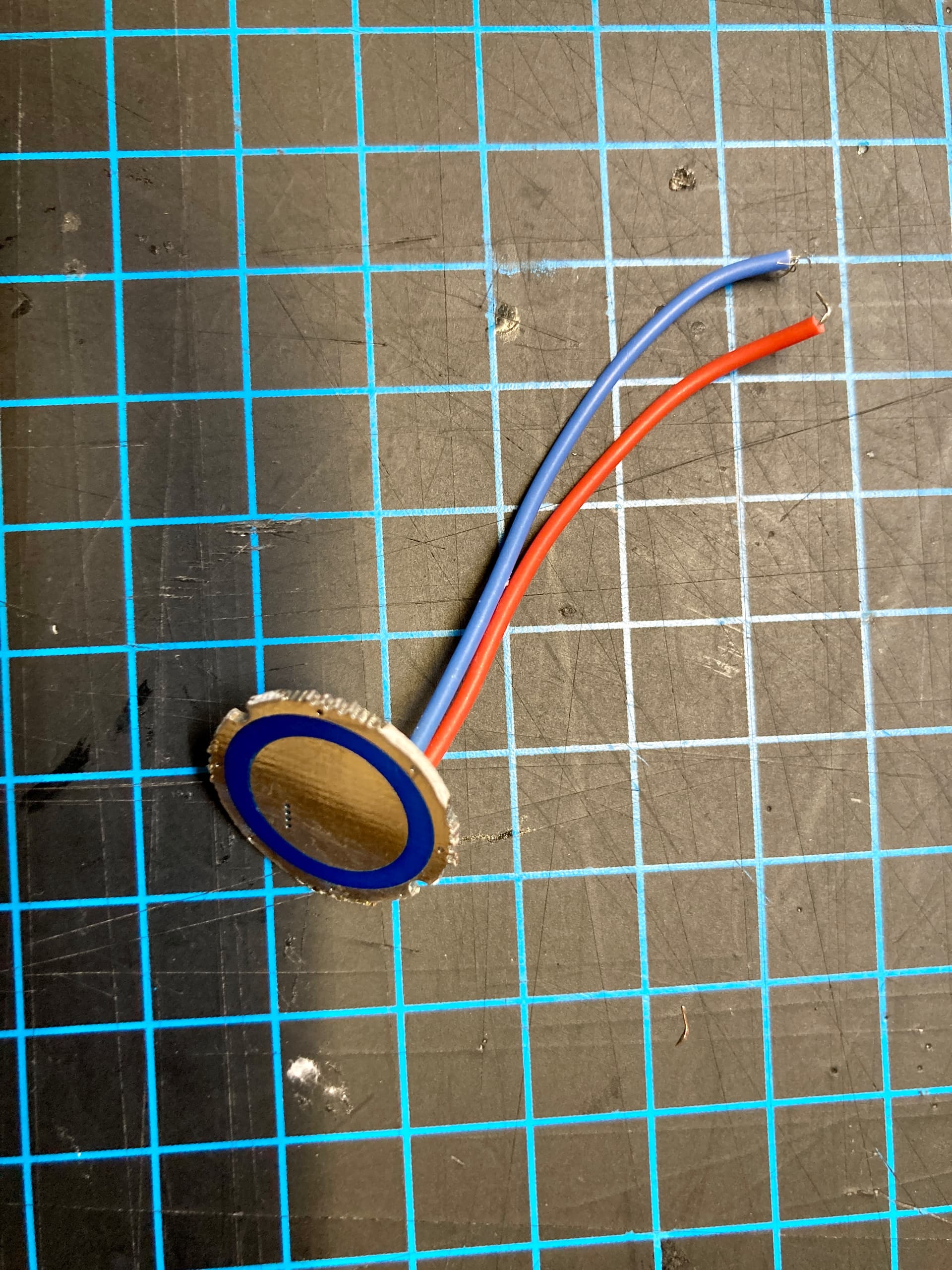

Here is a popular LED driver. It appears to be out-of-stock at the moment and it may need more voltage than you have.
Those boards need 4.5volt minimum, and have ~1volt dropout.
Unsuitable for a single LiPo cell.
Driving a power LED from a single cell is not simple.
It needs a current controlled buck/boost setup.
Maybe have to look for boards that are used in LED flashlights.
Or use a linear chip made for this, like the AMC7135.

I got this thing called YN-20-03
I don't know if would be useful or not I just bought when I bought the LED but I don't know exactly what it's doing or how it should be used. :man_shrugging:
