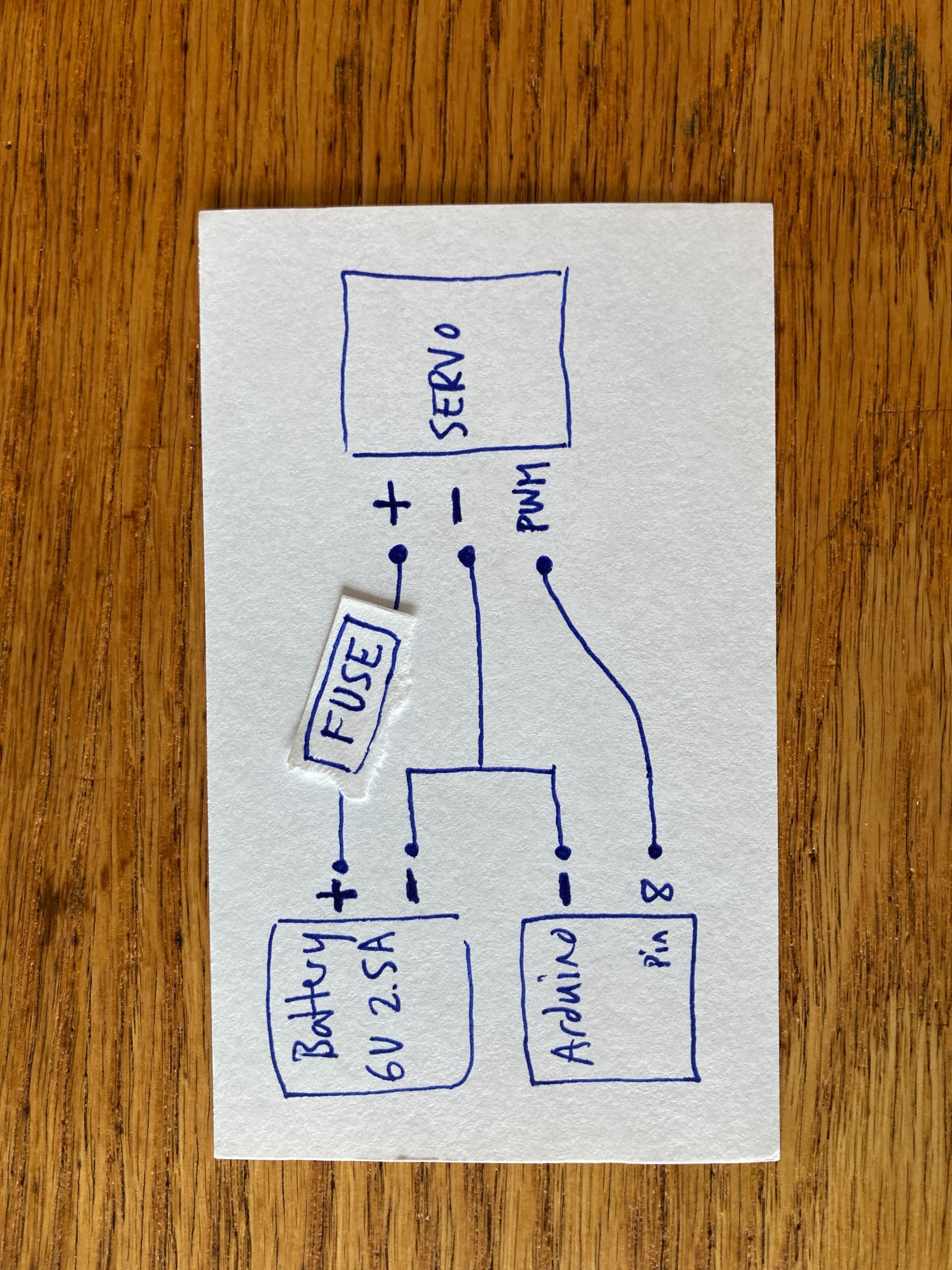

Would the circuit look something like this:
If I wanted to put in a fuse, would I put it in here? And should it be a 3A fuse?
Yes, that is how the servo, Arduino and power supply should be connected. Yes, that is good for placement of a fuse and 3A will be OK. Though a fuse is unusual it is not wrong.
Battery capacity is measured in Ah (Amp hours) or mAh (milliamp hours). How long do you want the battery to last? The battery must have the capacity to supply the average current that the circuit demands for that amount of time, hence mAh. Get a battery that has a capacity of twice (miniimum) the calculated mAh.
That's a really nice schematic :slight_smile: And yes, it's a suitable place for a fuse. The rating of the fuse should allow for the combined stall current of your motors plus a safety margin. A margin of 100% (double the current you anticipate to draw) is a good place to start.
One thing though: where does your Arduino get its power from in your schematic? :wink:
