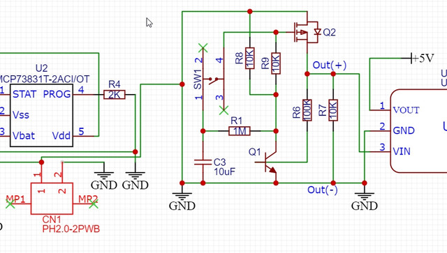

I could really use some help/guidance on a couple of issues I'm having. The first issue is that I'm trying to incorporate a soft latching power switch into my project. I'm trying to use the same circuit as the photo below.
The circuit is from here

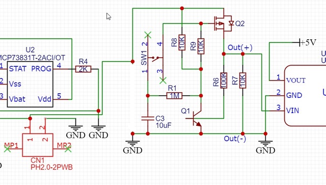

Below is an image of my current schematic. It may be a noob question but I'm completely unsure about how I'm suppose to connect the positive terminal of the JST battery connector to the soft latch circuit. The idea is that the battery would be enough to trigger the circuit and then that would run to the U3V12F9 boost converter which would then go to on to power the rest of the circuit with 5V. I'm not sure if I'm connecting the positive and negative outputs of the circuit to the converter correctly either. :confused:
My other issue is how to choose the correct BJT for Q1. For Q2 I've chosen a P channel MOSFET, the datasheet says that it has gate operator with voltages as low as 1.8V so I believe this should work. I've been researching about BJT's but I don't seem to be getting it. I'm still very new to electronics so there is a lot I don't know that others would probably consider common sense. Can anyone offer a suggestion or at least fill me in on what I should be looking for when selecting a component for Q1? I forgot to mention that the max draw of the system is 1 Amp but its usually much less. Also if there are any other glaring mistakes on my schematic please let me know, any help is greatly appreciated!
Battery goes in place of the DC supply symbol in the first circuit.
You have connected the load correctly.
You haven't said what the battery voltage is.
The p-channel MOSFET you've chosen has a gate-source absolute maximum rating of +/-8V
which is very low, but I presume the battery voltage is less than 5V given the boost converter
so that is probably fine.
Q1 is literally any small-signal general-purpose NPN device - they all behave the same to a
first approximation.
The soft-switch circuit only triggers when the button is pressed, and latches until power is removed.
Is that what you intend?

Connecting the battery in place of the DC symbol is the bit that's confusing me. I've highlighted the battery JST connector in red in the photo below. Can I simply take the positive terminal and connect it straight to the circuit like in the photo? I'm assuming that the negative terminal can go to the common ground but I'm not absolutely certain.
MarkT:
The battery is a single cell lipo and the voltage is anywhere from 3.7-4.2 volts.

That is taken directly from the site that I found the circuit from. So you're saying the circuit won't power off on the second press? :confused: That is definitely not desired. I just want the system to turn on with a press, and off with the second.
No, the circuit latches permanently once the button is pressed. If you want a toggling power switch its no use.

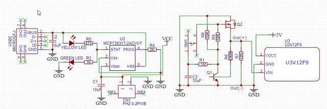

It's possible to make the OP's circuit work, but many of the values must be changed and it will not be very responsive. It would need about 5 sec or more between cycles for the RC time constants.
I think the circuit does push-on, push-off. It seems the description from the original site describes how it works, and I assume it was tested before it was piublished.
But your connection from the battery to this circuit is wrong. You are grounding the battery positive. See the attached revision instead.

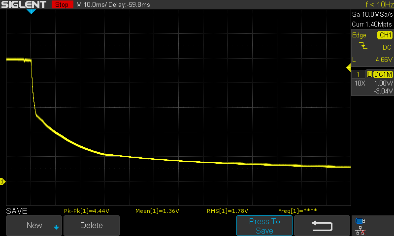

You are overlooking the 47uF decoupling capacitors on the Arduino load which can prevent the NPN
switching off unless the time constants are adjusted - also voltage rails for digital circuits often don't drop
very far immediately, as as soon as the oscillator stops the current consumption of a CMOS circuit drops
to near zero.
Here's an Arduino Mega (well Seeeduino Mega in fact) 5V rail when its unplugged from USB, at 10ms
per division:
It takes 2ms before the osc. stops, then the decay slows down considerably, taking 10ms to drop to 2V and
30ms to drop to 1V. At this point the NPN transistor would likely still be on when you release the button... This board has 22uF and 10uF caps in fact, not 47uF like the Uno, so it would be worse.
Its fine for switching resistive loads, but its not general and its not the simplest approach either which is to
use a DQ flip-flop which is designed to toggle reliably and not depend on the load's properties.
To fix the circuit you probably want to set the discharge time constant to 0.3s or so, and the capacitor
recharge to 2s or so.
