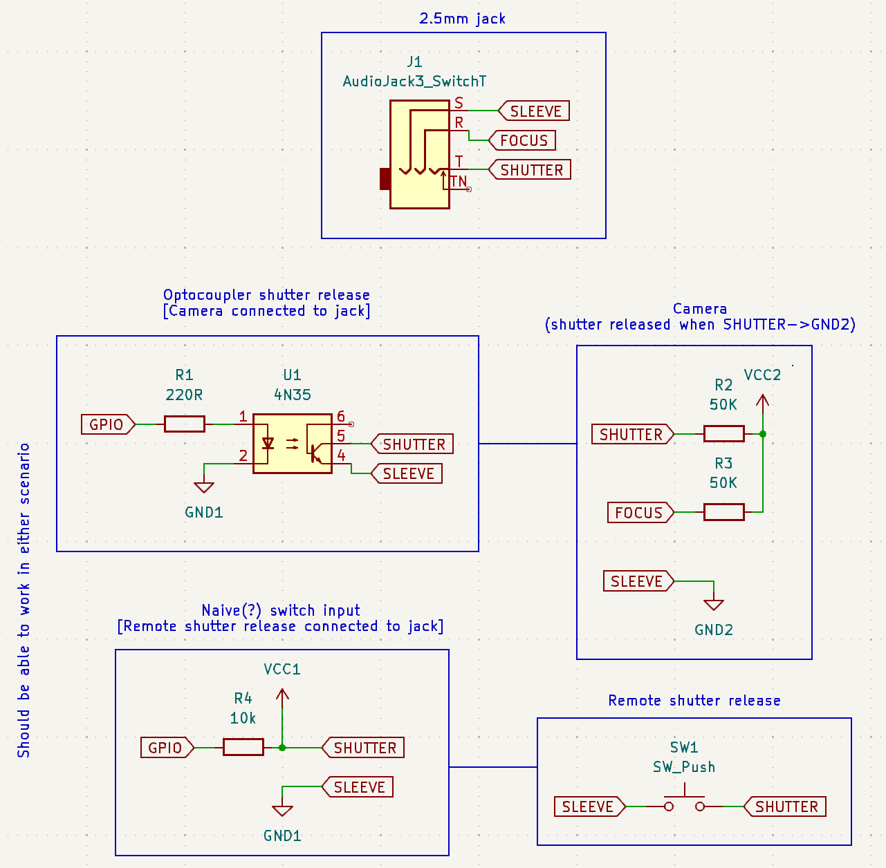

I'm trying to create a circuit that will be able to act as either the sending or receiving end of a camera shutter release (intervalometer). In particular, it will include a 2.5mm aux jack for use with the Canon shutter release system described here. To trigger the camera shutter, the sleeve (ground) and tip (shutter signal) should be connected.
To trigger the shutter with my microcontroller (ESP8266), I've used an optocoupler to connect shutter and ground while retaining isolation between devices. However, I also want to be able to plug in a remote shutter release, which is essentially just a switch, and detect its state as well using the same 2.5mm jack.
I'm still pretty new to electronics, but I understand that to detect the state of the switch I can just pull a GPIO pin up/down on one side and connect GND/VCC on the other side. My question is whether it's possible to safely do so while still being able to retain shutter release (switching) functionality when a camera is plugged in.
My fear is that no matter how I do it, I risk feeding too much voltage into either the camera or microcontroller. I have no guarantee of the camera's voltage, which is why I opted for an optocoupler for the original shutter release circuit. A side question is whether having common ground would be preferable (considering the camera will probably be battery-powered), and if so maybe this can be done with transistors? If the ground is shared, the camera can be triggered by bringing connecting the shutter pin the ground (digitalWrite(LOW)).
I would be using this 2.5mm jack, which has pads for sleeve (ground), ring (audio right/focus), tip (audio left/shutter), and tip switch.
Schematics:

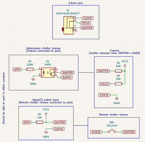

My bad--I've added some schematics to the original post. Let me know if there's more that I should explain. Thank you for your advice!

No problem, it's definitely my fault for not explaining clearer. There is a 2.5mm audio jack, which will be on a PCB with an ESP8266. There are two modes of operation I have in mind:
  1. Camera connected to jack. In this case, the EPS8266 should be able to trigger the shutter, hence the optocoupler idea.
  2. Remote shutter release connected to jack. This is an external device (like this) that is meant to plug into the camera directly, and is essentially just a fancy switch (but can be more sophisticated). However, I want to be able to plug it into the jack and keep track of its state.
So, either the camera or the remote shutter release could be connected to the jack at any given time. Use cases for the former would be what you mentioned: time-lapse or something similar. Use case for the latter would be, for example, triggering the camera shutter over WiFi (using ESP8266) whenever the remote shutter release is pressed (since many cameras don't have the physical shutter release port anymore).
I can't quite figure out how to support both of these modes using one jack. If it helps, there's also the tip switch (TN on the top diagram), which is closed whenever something is plugged in. Thanks again!
Tell us what the voltage is from the camera. An opto needs a voltage to be switched to ground for operation.
For my specific camera, it seems to be 3.3V, but it might differ between cameras. That voltage would be VCC2 in the diagram
Then use an opto for the lowest voltage. Make sure the camera voltages all have the same polarity!
The link in #1 shows the circuit in the camera. It's just a pulled up 3.3 logic line.

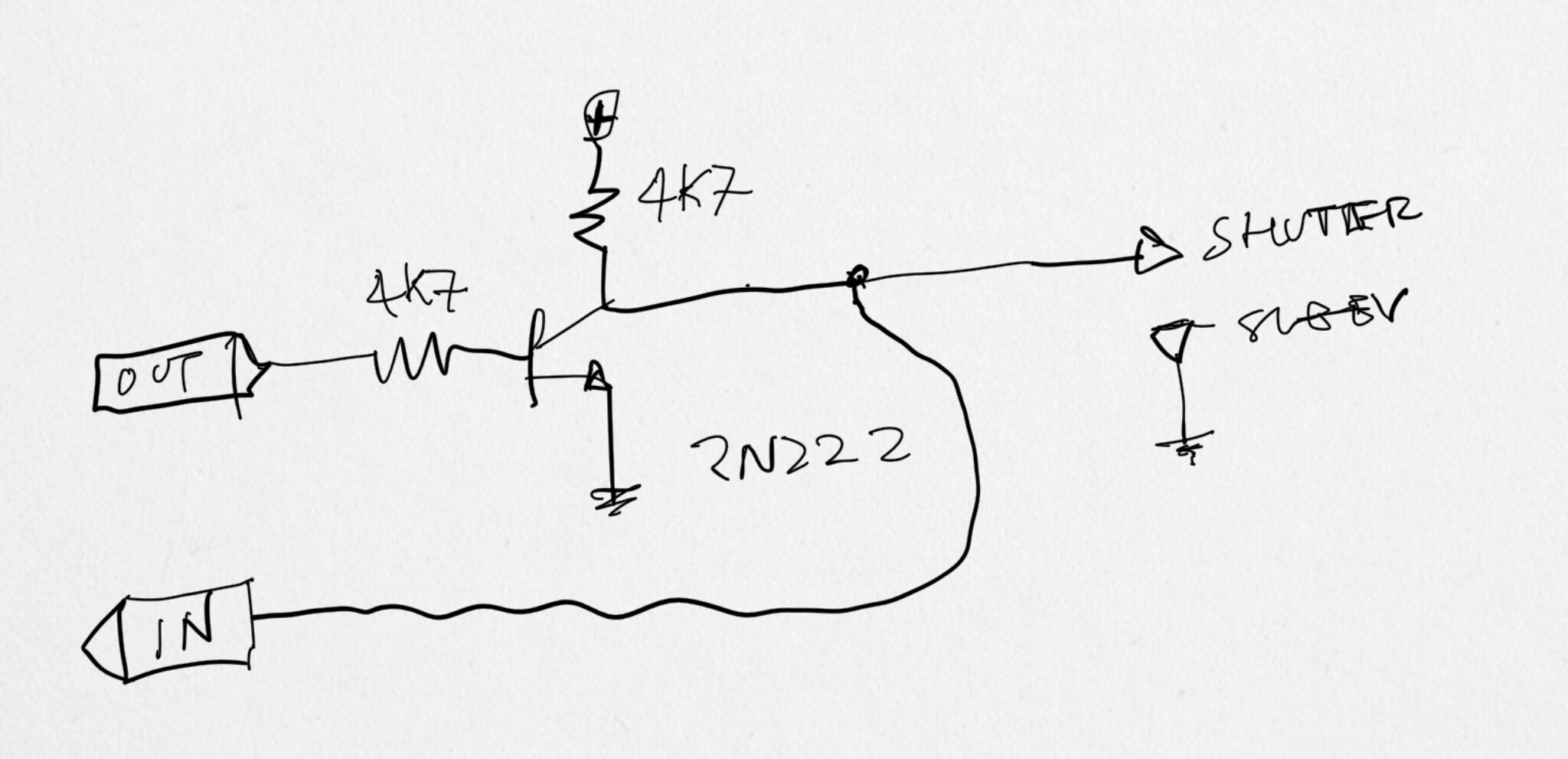

I had to use a common ground, thus opto-ed out with a transistor.'
If the camera is connected, the Arduino can control the shutter. Writing HIGH to the pin will be the same as pressing the button. Take a picture.
If the remote shutter device is instead connected, the Arduino can read the state of that switch or switch equivalent. A LOW reading would correspond to a closed switch. Do the Wi-Fi thing for the camera.
@Paul_KD7HB reminds us to check the voltage and polarity. Any remote shutter device that is not just a mechanical switch must be able to pull down the 4K7 resistor, which could be much larger if need be.
