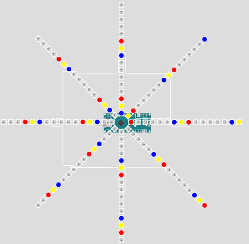

@hossein8m - I made something that you might want...
@J-M-L - pattern 1 code crunched...
Who is smuggling I AM smuggling the algorithm!
Pattern 1: Colors determined by position inside three nested loops (boring, but tight):

Pattern 2: RYB showing the spirals involved in Pattern 1...
