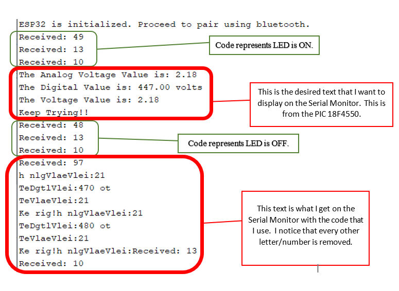

Problem: I am writing to ask for guidance and advice on a situation that I dealing with on the Serial Monitor in conjunction with the Print/Write Commands. The problem I have is the text that I want to display (which is data from a PIC microcontroller) will not completely display - every other letter/number/symbol is removed. Example the phrase "I'm going somewhere to eat." will read on the Serial Monitor as "Imgigsmweet a.". What would cause this particular situation? Any and all advice would be greatly appreciated.
Background: I am using a PIC 18F4550 microcontroller and the Adafruit Huzzah32 - ESP32 Breakout Board (Bluetooth Device). The PIC 18F4550 is being used to collect voltage readings and convert them to analog and digital values from a variable power supply. The PIC 18F4550 is connected to the ESP32 using serial communication. The objective of the ESP32 Bluetooth Device is to collect the data from the PIC 18F4550 and send it wirelessly (i.e. Bluetooth) to my cell phone. The results of the data being displayed on my Cell Phone are the same as the Serial Monitor. I do use the Serial Monitor as a means to check my code.
Conclusion: I would like to know why the data from the PIC microcontroller would have every other letter/number/symbol removed. What concepts or specs or codes am I misunderstanding or lacking in knowledge with Arduino/PIC/ESP32 that would help solve this situation? I have attached my code, a diagram of the general layout of my hardware, and both the Serial Monitor and my Cell phone as it displays the data from the PIC 18F4550. I hope that I covered the necessary items needed for your help and if not then please let me know. I do thank you for your time and any and all help on this.

For what it's worth I have a similar project with a PIC connected to an ESP8266. The ESP8266 I have has a 128 x 32 OLED on top, brilliant for displaying debug messages.
   while (Serial1.available())
            ESP_32.write(Serial1.read());
            Serial.write(Serial1.read());
                                //Previous two codes write data from PIC and
                                //display it on CELL PHONE & SERIAL MONITOR.
Every time you use Serial1.read(), you are reading in a character from the serial port. The two write statements above will each read one character, for a total of two, with the ESP_32 and Serial each getting every other character from the input. If you want to write an input character to two different outputs, you need to read it into a variable first, then write the variable.
Oh, wow! You're a diamond!! Thank you for sharing that info PerryBebbington!! I'll see if I can do that now b/c that shows all of what I am trying to relay but visually!!
I give credit to PerryBebbington on having an image placed on my post and again thank you!!
The pictures below are the diagrams and results of my project that I am having issues with. I hope that gives better clarity of my situation and thank you all for your help!
First - The Hardware Layout of the Variable Power Supply, PIC, and ESP32:
Second - The Data being Displayed on the Serial Monitor:

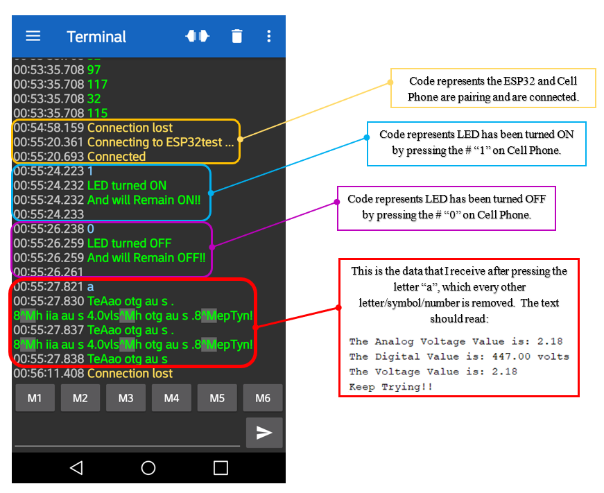

Third - The Data being Received by the Cell Phone:

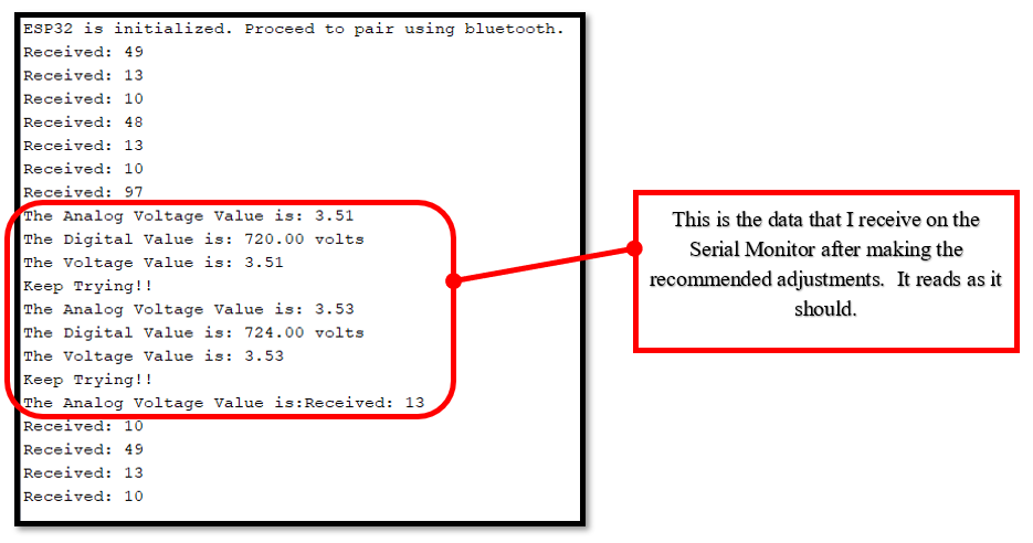

Looks correct, but use char or byte, not String, you are only reading a single character at a time, and String often leads to memory corruption problems.
Hey, david_2018! This is what I did and I greatly appreciate your help on this. And here are my results:
1. create a variable (char/byte will work - I did both!) ---> char SERIAL1_DATA;
2. assign said variable to Serial1 Port ---> SERIAL1_DATA=Serial1.read();
3. use write command to write on Serial Monitor and Cell Phone:
ESP_32.write(SERIAL1_DATA);
Serial.write(SERIAL1_DATA);
When placed and uploaded the Serial Monitor read the results that I was anticipating. The Cell Phone read the results but had a slight issue, which I am curious on but overall I am quite thrilled at the results! I have attached the results (displaying a message of analog and digital voltage values) of both the Serial Monitor and Cell Phone and updated the code.

A better display of my attachments are below:
1. The Data on the Serial Monitor - Better Results!
2. The Data on My Cell Phone - Close to What I want BUT BETTER!
  • I would like to know why the two characters ^M are displayed at the beginning of my messages and curious as to what is the best way to remove them? I think I need to adjust my code in the PIC 18F4550?
  • I am curious to know what is the significance with using the char/byte over the String as a variable for the situation I am in using Serial Communication? Is it because a String is an array of characters (or multiple characters being) being read a once rather than one character at a time due to the nature of Serial Communication? I would like to know and understand this concept of using variable types and Serial Communication. And it would be appreciated.
control M is a carriage return, in ASCII code it is decimal 13 or hexidecimal 0x0D. Easiest way to correct the cell phone data is probably to just not send the character if it is a carriage return

Wow! Thank you david_2018!! You sir are gold!!!
I used the added code that you created and it worked. I used both decimal 13 and hex 0X0D to see what would happen and sure enough the carriage return symbol was removed! I would not have recognized the carriage return "^M" had you not identified it. I did not know that ^M is a Caret Notation, which is used to represent control characters on a terminal (in my case the app called Serial Bluetooth Terminal). The more I need to learn!
On the topic of the char/byte and String use, thank you for the verification on the data representation of the data being received or not. Also, your assessment on Arduino and String, your knowledge is impressive. Thank you for sharing and helping me out on this. I will attach and post the results on my Cell Phone, which should conclude this aspect of my project. Thank you all for your help and sharing your knowledge with me!! I'm looking forward to the next post.
