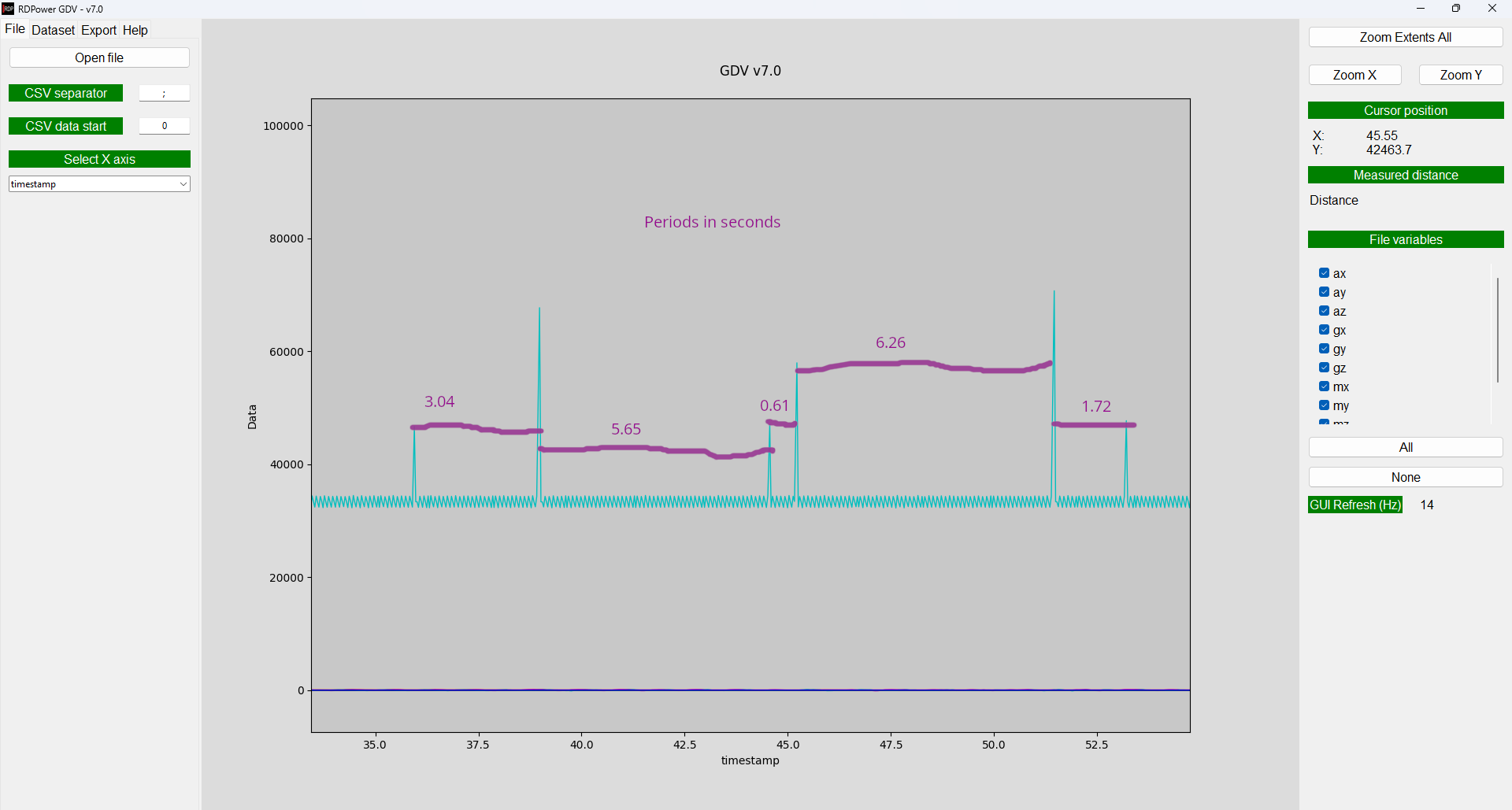

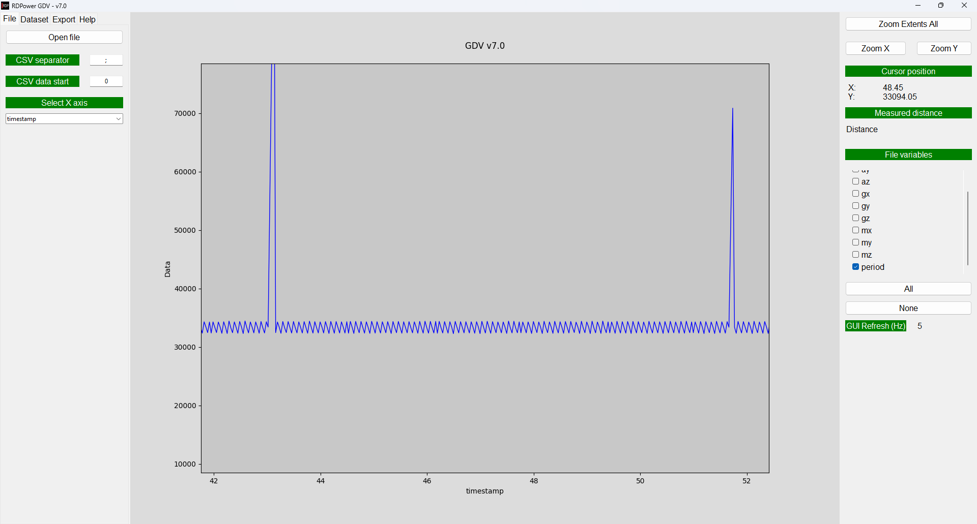

I want share with you some tests i have made with my code.
I added to the log file also the timestamp of each reading, i used for simplicity the micros() value from arduino library, in the future, i will use the real timestamp taken from RTC of the nrf52840 of the nano 33 ble.
In the following images you can see the period of each saving, that as expected, is about 33333 uS (see image 3), because the logger is running at 30 Hz. But as you can see the period is not fixed and varies of about +- 1000 uS (image 3), i don't understand this.
Also, as you can see in images 1 and 2 i have sometime small pauses that can be also 70000 uS , about double of the normal period. These pauses appens every some seconds. These pauses obviously slow down my logged data and i loose about 0.6% of the values during the logging.
I can imagine that these pauses are in some way related to SD writings, but i cannot understund why they are so impredictable.
The flush() command furthermore is executed every 11 blocks of 512 bytes (5632 bytes) so it appens every 8.53 seconds, but it does not seems to be related to the spikes.

As i added 4 more bytes of the timestamp (uint32_t) to each cycle, the least common multiple of 22 and 512 is 5632 bytes.
