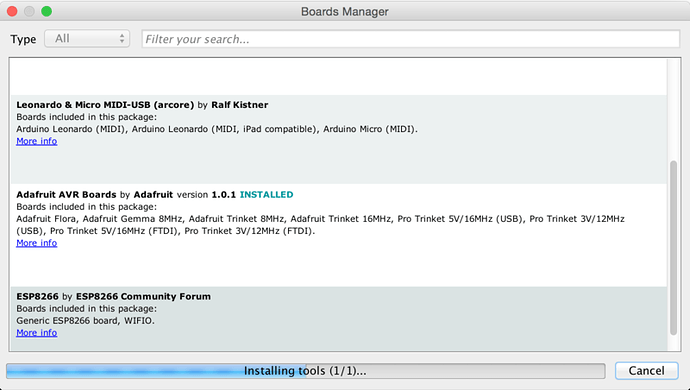

You be interested in this hack Adafruit made to take advantage of the Arduino Boards Manager system to distribute their boards platforms after the initial release of the feature before the Arduino developers had added the formal support for 3rd party package index URLs:
