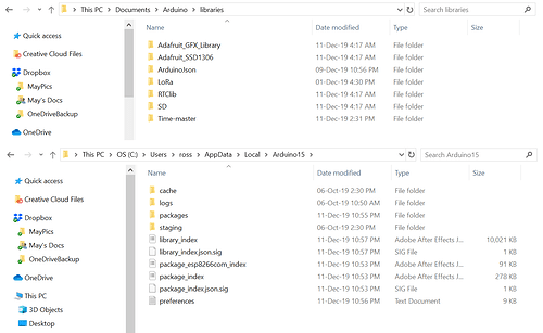

Oh 1 more thing, with IDE built 1.8.x i noticed that the progress bar fills up all the way to the end, way before the compilation is complete. The compilation process is not complete until the compiler answers back at you either with error messages & terminated or completed. It may take quite a while depending on your hw-configuration, but refrain from hitting the compile or upload button while it's compiling.
Thanks Deva_Rishi for your response - it's much appreciated. I think I only had one version of ESP8266 installed (see pic below).
BOARD ESP8266
I uninstalled ESP8266 board and re-installed using version 2.4.2. Now I'm looking into the duplicate libraries issue. Is there a "default" location where all libraries should be installed?. I seem to have libraries in two locations:
LIBRARIES
Searching C: drive for ESP8266WiFi.h only finds one file in this folder: c:\users...\Arduino15\packages...
Searching C: drive for ArduinoJson.h only finds one file in this folder: c:\users\ross\Documents\Arduino\libraries\ArduinoJson...
there are actually 3 main locations, The second you see is the ESP-core specific location, those libraries are builtin to the core installation. (AVR has a folder for that as well) The first is the Location for libraries that are builtin to the IDE install (but not core specific) and as a subfolder to your main-sketch folder you can install user or custom libraries that you will want to retain if you upgrade the IDE.
I was basing that on the error msg, that involved a file in ...\tools\2.5.0.. to which access was denied, maybe that is just being used by 2.6.2 as well.
