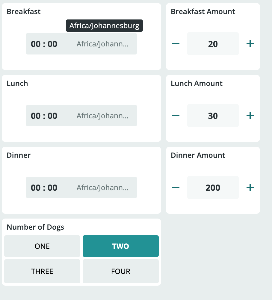

Hi there
I am building a dog feeder and I have some code where one defines the time that the dog is fed. When I try and change that variable on the dashboard it sets itself back to the default 00:00 after a few seconds. This error only occurs on the web dashboard. Here is my code:

Dashboard:
Thank you in advance for all the help.
