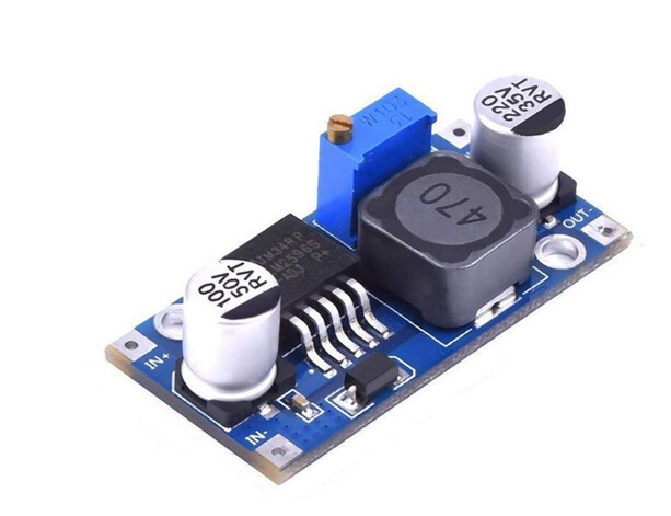

XL6009E1
You appear to have shown a buck (step down) converter in your illustration. Notice that the input side is close to the chip.
Here, in a boost converter, the output is closer to the chip:

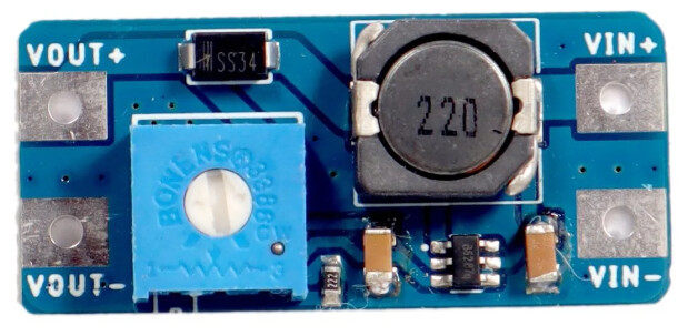

Yes, it is possible I grabbed the wrong image. My apologies. What I actually have is this chip
On closer inspection it seems this is called a MT3608, not CN6009. My apologies again for the oversight and thank you for the correction!
