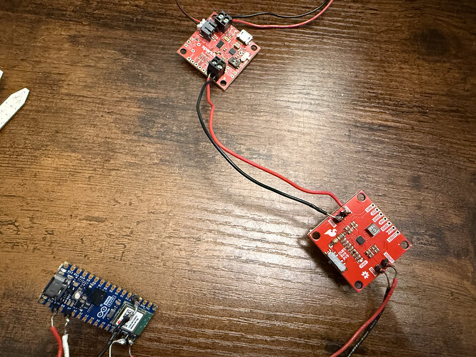

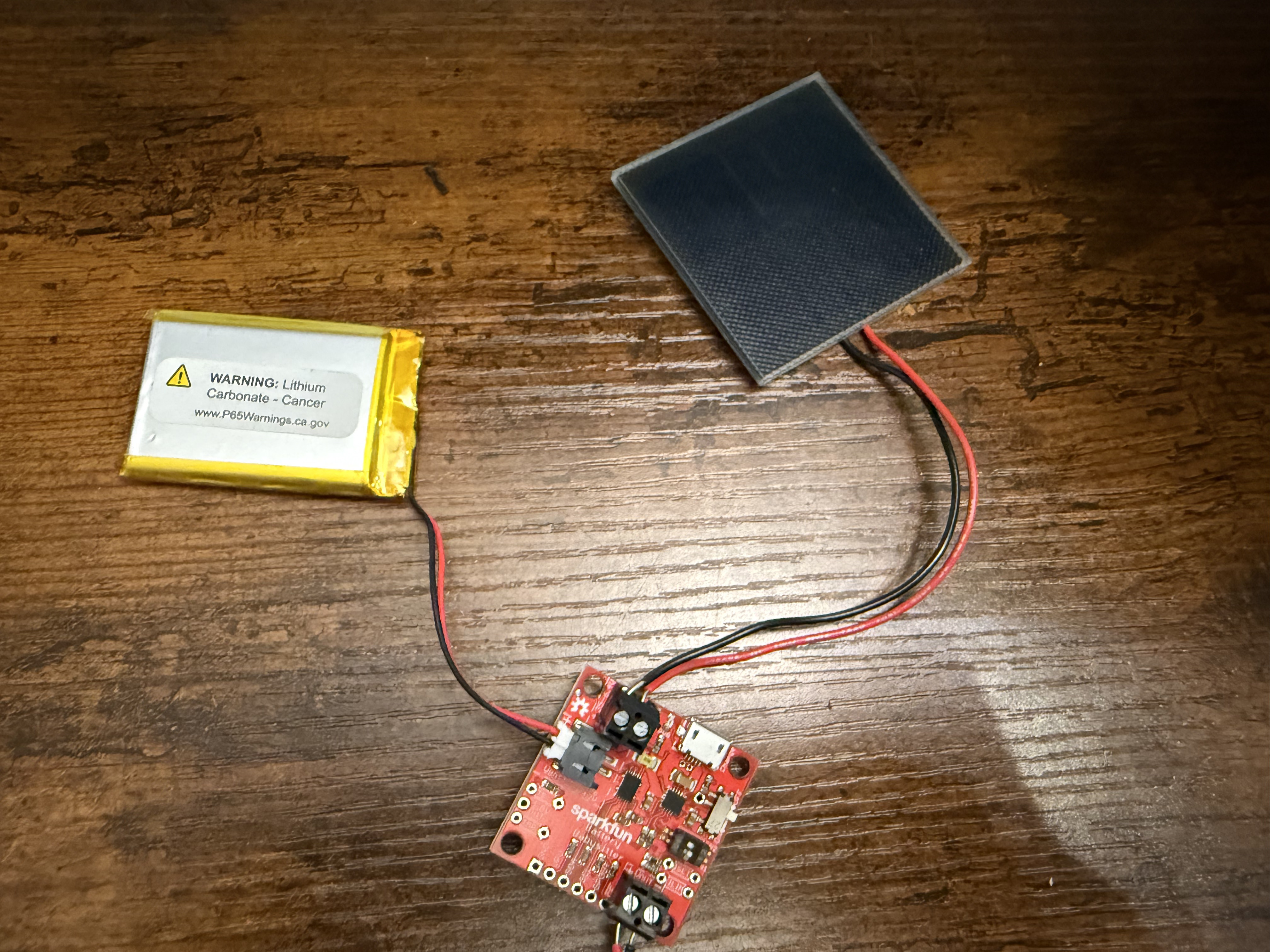

I have the circuit below that implements the following components that is not working as intended:
1300 mAh lithium ion battery
Solar panel: Mini Solar Panel - 0.3 Watt, 6 Volt (ETFE) - SparkFun Electronics
Buck Boost Converter: SparkFun Buck-Boost Converter - SparkFun Electronics
Babysitter: SparkFun Battery Babysitter - LiPo Battery Manager - SparkFun Electronics
Solar Moisture Sensor Drawing.pdf (59.1 KB)

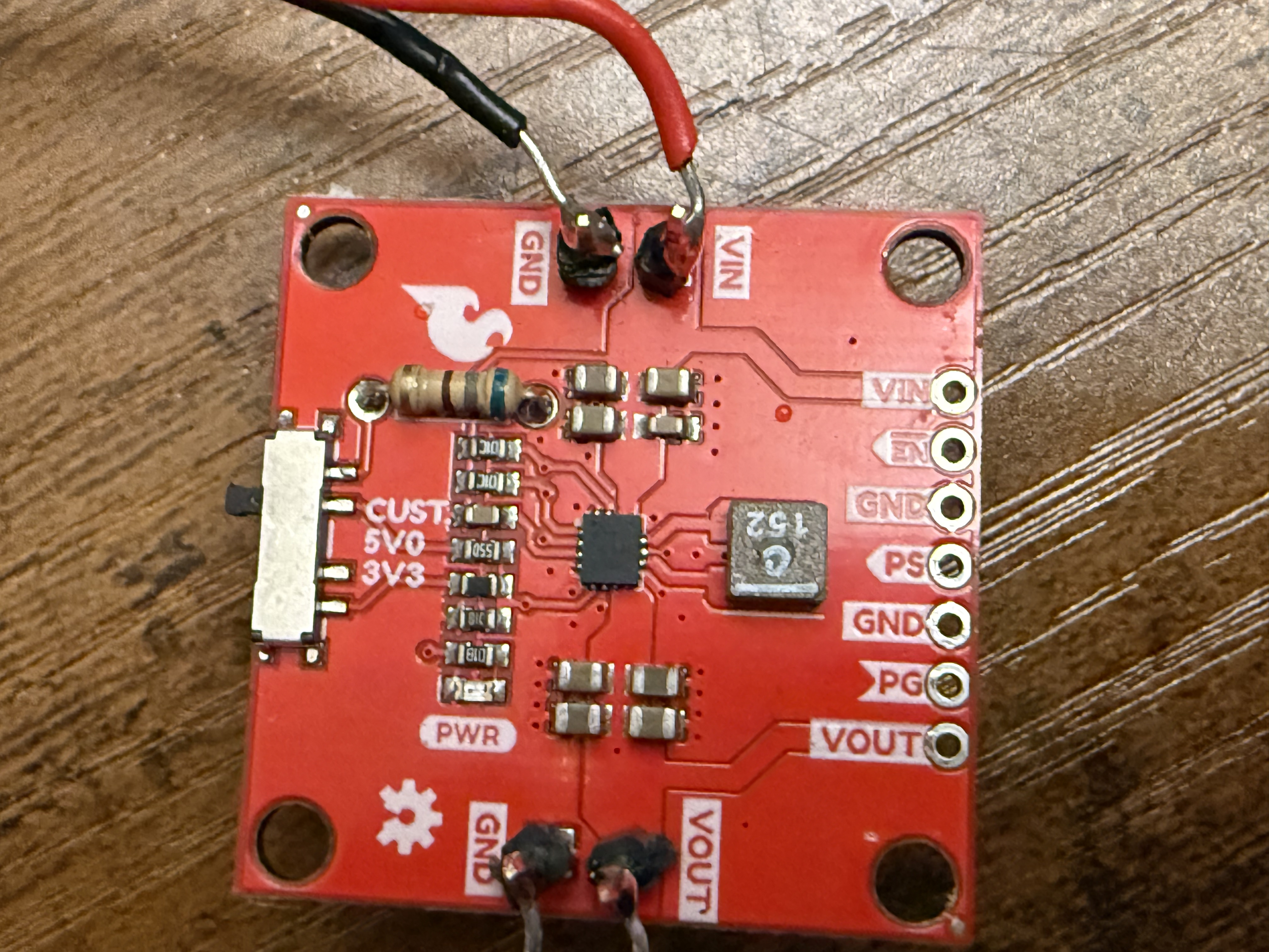

I have a 6V 0.3 Watt solar panel connected to the Babysitter, which connects to a buck boost converter that is connected to the Vin/ground pins on an Arduino Nano ESP32. The reason for the buck boost converter is that is the output voltage of the babysitter is not high enough to power the ESP32.
The solar panel works and the battery charges, but I'm not getting any power to the Arduino and I'm not sure why.
Is that switch on the buck/boost set to 5V?

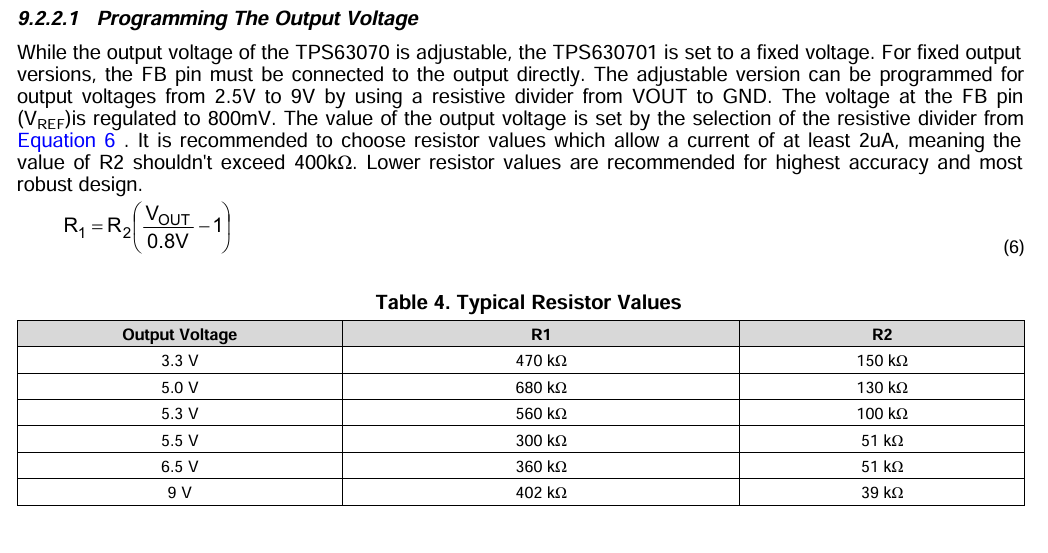

It is set to "custom". There is an equation to determine the resistor needed for a given voltage output:
Equation to calculate resistor value
I have a 680 OHM resistor which means the output should be about 8.7V.
Is that resistor soldered on?
Are the pins on the nano soldered?
Yes.

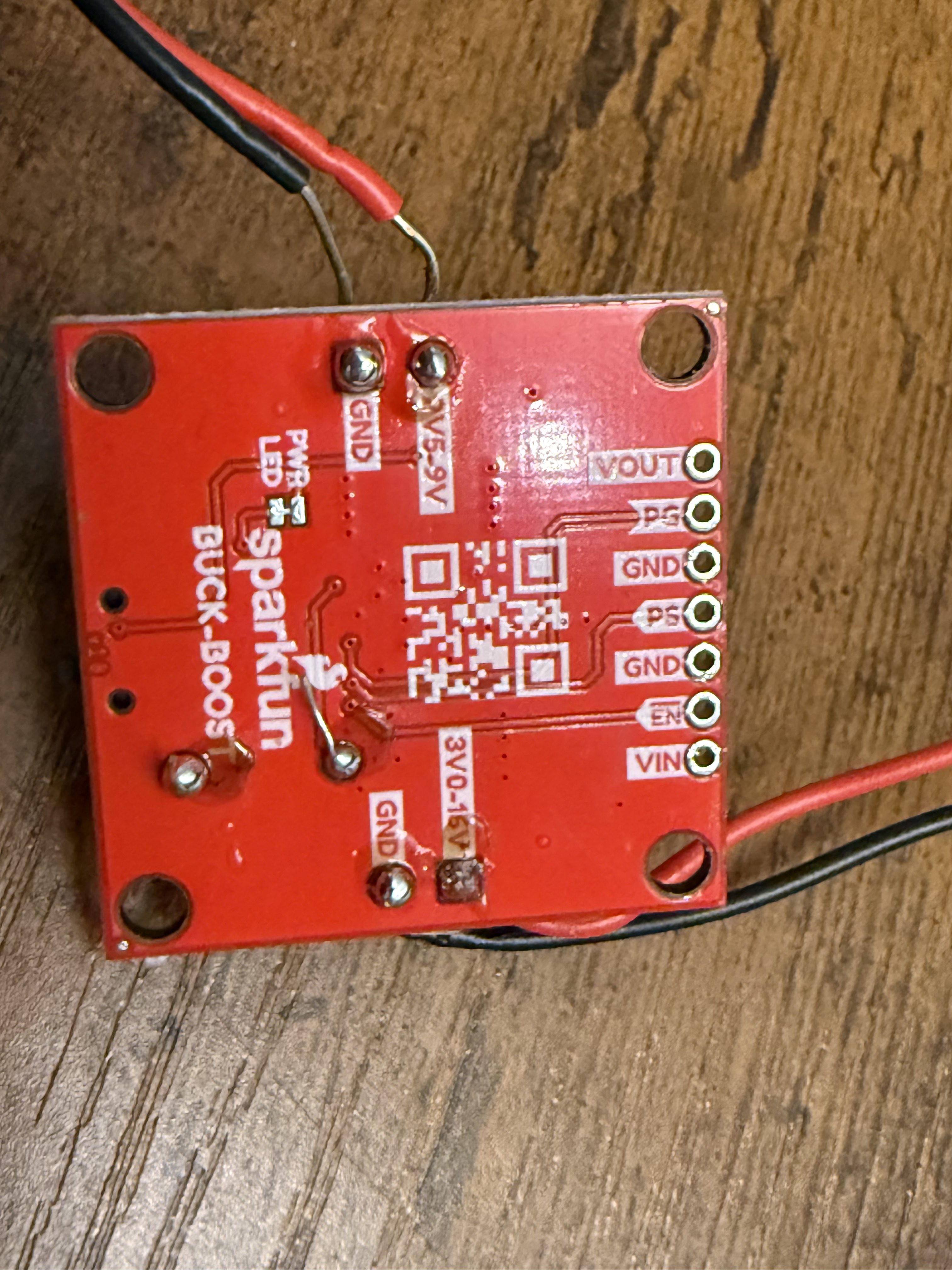

Not to sure about you soldering, may have a bad solder joint somewhere.
Did you measure the voltage going into and out of the buck/boost?

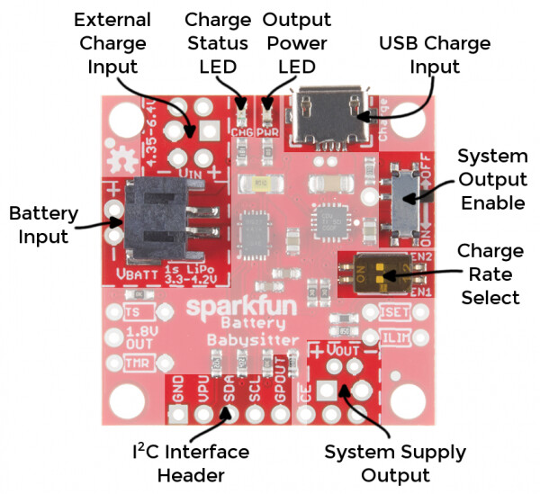

There is no voltage coming out of the Babysitter despite the battery being full.

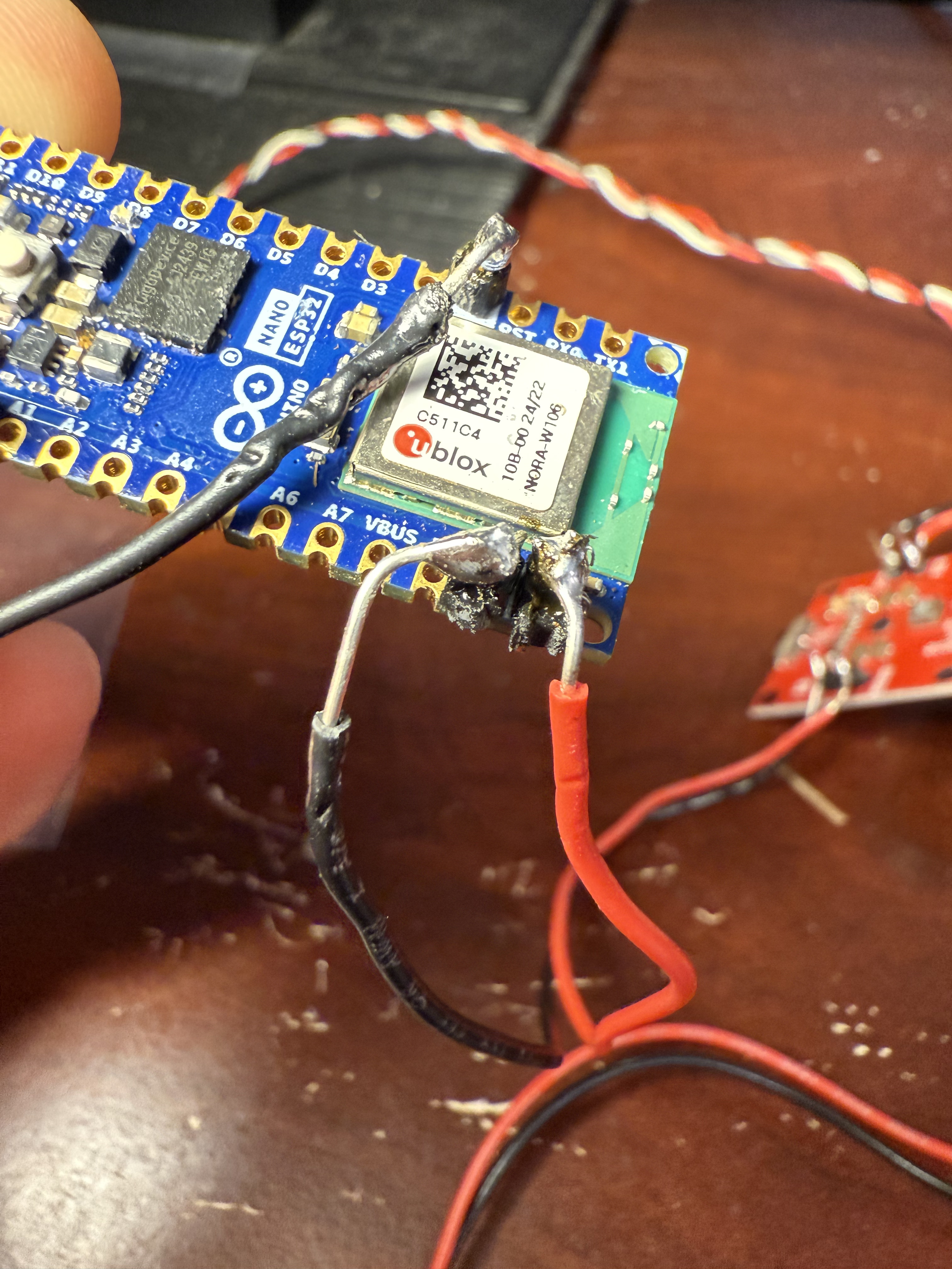

I have to agree with @jim-p and say it is highly probable you have a bad solder connection. It is very hard to tell as the joints have not been cleaned. Isopropyl alcohol 91% and some cotton tipped swabs works great for me.
I recommend getting some materials to practice your soldering skills. From what I can see, you may not be heating the solder enough for it to flow properly, and you might not be using enough of the proper flux. Practicing on old boards will allow you to experiment without risking damage to valuable components.

Are you sure that charger board can work with a solar panel. Solar panels are mainly current sources, not voltage sources like a supply or battery.
The panel also seems way too small to be effective.
That doesn't explain why the boost converter doesn't work from a fully charged battery.
Leo..
It should be 680kΩ, not 680Ω !
Well that is a problem and needs to be solved first.
Disconnect the buck/boost and the solar panel then measure the voltage output from the babysitter.
We will worry about the buck/boost problem next.
Hi, @mfusco
As @Etienne_74 has pointed out;
equation
Badly written equation, BODMAS.
R = 68.1 x ((8.7 / 0.8)-1) KOhms
R = 68.1 x ( 10.8 - 1) KOms
R = 68.1 x 9.8 KOhms
R = 672.4 KOhms
R = 680 KOhms.

Is the system output enable switch on?
Also see post #11
TPS63070 datasheet --
