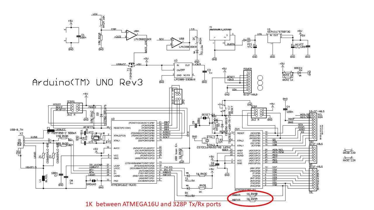

Also attache Arduino UNO schematics to show the loading of Tx/Rx ports.

  1. The capantance of the oscillscope probe is ~ 400-500 pf. I tried 400 pf and 1000pf (1nf) both are OK. So I just add 1nf capacitors to both Tx and Rx pins.
  2. By adding the 1nf, 4 out of 6 new boards (SMD 328P-AU) work fine ( Can continue for >30mins) without stopping (Test 6-1) So it shows the decoupling capacitor can help.
  3. I made the buffer amplifier as planned. But need change to use PNP type transistor for the normal state of these TX/Rx pins are at high (5V) . After add this amplifier (Test 4-1), I can mornitor the commands in between PC and UNO boards. The commands runs very fast, I can read last few commands after, but can't see what's the problem when the board REST and stopped. The commands just stopped...... . So I still didn't find the root cause why it was stopped.
  4. The next I did the bypassing CH340 of new UNO boards ( Test 5-1). By doning this, 4 out of 6 boards runs well. The 2 failed in Test 4-1 were still failed in this test.
So it seems the failure is coming from the 328 TX/RX I/O port ? That is SMD tpye 328P-AU on new UNO boards?

Yes, thanks for the suggestions. I can use alternative ways to do this. it's just because I don't have Bluetooth on hand, and didn't use it before. I have several UNO boards on hand, and knowing the HW interface in between. There is no harm if I connect in the way I did, please see the brief curcuit drawing attached. Use 2 UNO boards to monitor Tx/Rx commands is simpler to me.
