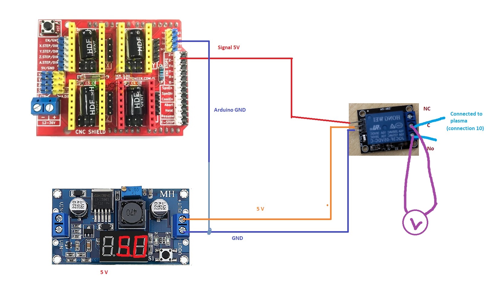

Since 6 months, I'm building a CNC Plasma cutter controlled by an arduino UNO R3 and a CNC Shield.
I'm using GRBL inside the arduino to controll the motor with CNCJS to have an user-friendly software.

My plasma has a connection for the torch (the 10 in the 125 CNC page of the user manual), where it's connected to... the manual torch.
I want to replace it by a relay (cf the picture) controlled by the arduino, so I will be able to control the fire of the torch. My wiring is in the attachments.
When the plasma is off, everything work well. I can control the relay. But when the plasma is on, 1/10 it's starting correctly, but most of the time, it's crashing the arduino (litteraly, in the bash of CNCJS, lot of errors pop) and it's blocking the relay. I have to restart the arduino by disconnecting the power source of it (USB or a 5V "converter", I don't know exactly the term, see attachment).
With a multimeter, when I'm triggering the torch with the relay, I can see a huge voltage for less than 0.5sec, very brief (maybe it's coming from the arc start of the plasma, I don't know).
May be I have to wire a flyback diode ? I don't know and like I said, I'm running out of solution and don't know where the problem is coming from...
I would be gratefully if you can help, and if you have questions, ask me, I will try my best to answer.
Thanks.
Nice job with the post. Take a look at your relay module, it is behaving like it does not have an opto isolator. There are a lot of them on the market from China. If that is the case replace it with one that has an opto isolator and your problem should be resolved. You may also consider using a snubber circuit across the relay contacts, the correct configuration can be easily looked upl.
Thx :slight_smile:
I will try to order a new one with opto isolator.
The snubber circuit has to be on the relay torch side, isn't it ? Just to be sure, that I'm understanding well what you say.
Happy new year btw :3
