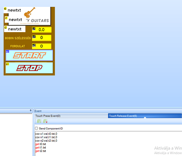

unfortunately the start button still doesn't work
Could there be an issue with the Nextion display configuration?
program.s
//The following code is only run once when power on, and is generally used for global variable definition and power on initialization data
int sys0=0,sys1=0,sys2=0     //At present, the definition of global variable only supports 4-byte signed integer (int), and other types of global quantity declaration are not supported. If you want to use string type, you can use variable control in the page to implement
printh 00 00 00 ff ff ff 88 ff ff ff//Output power on information to serial port
page 0                       //Power on start page 0
bauds=38400
I really know nothing of the Nextion displays. So can't be of much help there.
That should set up the SoftwareSerial port on those pins (A0 & A1). If it does not work, I am at a loss.
What is that? Does the Nextion need 38400 baud? If so change the

38400 is about the highest baud rate that SoftwareSerial will reliably run. Use wires as short as possible between the shield and Nextion.
I got it to run for a while, but it was weird. For example, there are three inputs on the display:
  • Wire diameter
  • Coil width
  • Number of turns
Normally, when it runs, it should count down the turns, but it was displaying some random numbers. After a couple of tries, the result ended up running constantly, meaning the countdown zeroed, but the steppers kept going forever.
I unplugged everything, then turned it on again, and it doesn't work anymore.

The default baud rate for a Nextion display is 9600. Until you have things working reliably it does not make sense to change it, you are just adding something else that might go wrong.
Please post a schematic, your photos are better than nothing, but don't help much. From what I can see in the photos you have not connected a ground between the Arduino and the Nextion.
You said in your PM to me that you have read my tutorials, but your Nextion code and the lack of a ground connection, along with not providing a schematic suggests that you should read them again.
Thank you for joining. Yes, I've already reread some of the materials (not all, but I have a better understanding now), and I feel embarrassed about how I initially approached this topic. I'm currently in a phase of my life where I'm unlearning and learning simultaneously. I express gratitude for everything every day and appreciate even the smallest things we have. It's just the way I am—my mind resembles a browser with 40 tabs open, 4 of which are frozen, and I'm still trying to figure things out. So, I apologize once again. I'm doing my best.
I don't have much experience with Arduino. I've built my own CNC router, similar to openbuilds machines, using a CNC shield. I'm eager to build more machines with Arduino, which is why I'm learning. Additionally, I'm working on a guitar project for a friend and using it as an opportunity to learn about the Nextion HMI.
I've created this schematic; I hope it's clear enough and doesn't seem inadequate to your eyes.
The stepper motors are connected correctly, and I double-checked the wiring for A1, B1, A2, and B2 before connecting. They are functioning properly. Establishing the GND connection between the Nextion and the CNC shield was beneficial; now, it's up and running. However, I'm still encountering some issues related to the Arduino, I believe.
I'm still facing two problems: Firstly, the stepper motors don't turn the same amount I input. Secondly, once it's finished and zeroed, I'm unable to start another cycle.

Hello, @PerryBebbington,
Thank you for your response. I've successfully established a connection between my Arduino and the Nextion display, and it appears to be functioning correctly. I've conducted debugging through the serial monitor, and all inputs seem to be working as expected, affirming a good connection.
However, I'm encountering an issue with the machine's functionality. Although it runs and performs countdowns, it's not responding to the A and B variables.
There are three input variables: A (wire), B (coil width), and C (turns). Among these, only the C variable seems to have an effect within the sketch. The others are solely visual; the sketch checks if they're non-zero before functioning.
Remarkably, there's a fourth variable called "L", not inputted from the display, serving as a 'static' variable within the sketch. It controls the motor movement's travel distance, a role that should be fulfilled by the A and B variables, not L.
My goal is to have the Y-axis execute a movement with a maximum distance equal to the B variable, stepping by the value of the A variable. This should continue until the C value reaches zero.
For instance:
A = 0.1
B = 15
C = 200
The X-axis initiates full revolution rotation. After each full revolution, C decrements. Meanwhile, the Y-axis travels the A value at each full X rotation until it reaches the B value. Then, it repeats this process until returning to the start position, looping until C hits zero.
I think the issue doesn't lie in how the Nextion communicates with the Arduino; it might be functioning correctly. It seems the void Data section is fine, and the necessary changes should be made in the loop section. It's possible I overlooked this question initially and got lost in the details. Despite trying numerous approaches, I haven't been able to make it work as intended.

#include <Stepper.h>
#include <Arduino.h>
#include "BasicStepperDriver.h"
#include "MultiDriver.h"
#include "SyncDriver.h"
#include <SoftwareSerial.h>

  if (mySerial.available()) {  //Is data coming through the serial from the Nextion?
    inByte = mySerial.read();
    // Serial.println(inByte); //See the data as it comes in
    if (inByte > 47 && inByte < 58) {  //Is it data that we want to use?
      message.concat(char(inByte));    //Cast the decimal number to a character and add it to the message
    } else if (inByte == 255) {        //Is it an end byte?
      endBytes = endBytes + 1;         //If so, count it as an end byte.
    if (inByte == 255 && endBytes == 3) {  //Is it the 3rd (aka last) end byte?
      QTY = message.toInt();               //Because we have now received the whole message, we can save it in a variable.
      message = "";                        //We received the whole message, so now we can clear the variable to avoid getting mixed messages.
      endBytes = 0;                        //We received the whole message, we need to clear the variable so that we can identify the next message's end
      numMessages = numMessages + 1;       //We received the whole message, therefore we increment the number of messages received.
      //Now lets test if it worked by playing around with the variable.

I changed the abbreviations to words. 'L' represents the 'number of rotations.' Frankly, I don't understand the code that came with the tutorial from that person named Sandy at github. It simply doesn't make sense to me how he created this project. Seems rather pointless.
I've attempted various programming approaches to achieve my desired outcome, but unfortunately, it's still not functioning as intended. I'm feeling a bit fatigued with this project. Do you happen to know where I could find professional assistance for a fee?
