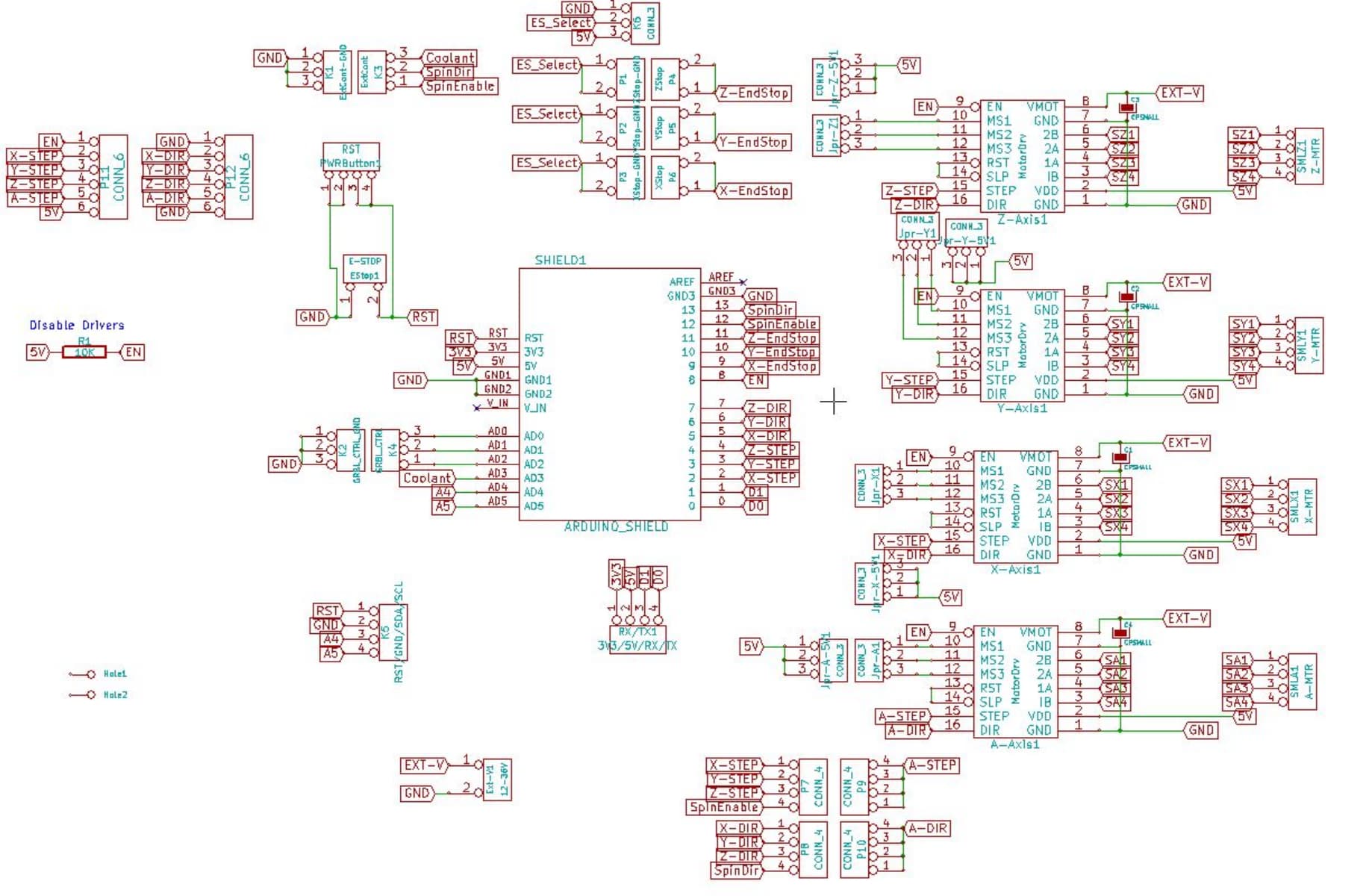

Get hold of the pin usage of the shield You have told nothing about.
In a commonly used CNC shield v3 from Prootooner there are inputs for end switches, if it is that shield.
For the CNC shield V3 here is the pin mapping of the shield to an Uno. If you have used the X, Y and Z limit pins (pins 9, 10, 11) there are still pins 12 and 13 and the analog input pins. The analog input pins are really digital pins with analog input as a special purpose of analog input so you can use them for digital IO. Those pins have internal pullups, too.
Make sure that you set the coil current limits on the DRV8825 drivers. That is important. See the Pololu DRV8825 driver page for instructions.
For a display, the I2C pins (A4 and A5) are broken out on the shield. So a 1602 or 2004 I2C enabled display is easy to connect. Use the hd44780 library to control the display.
CNC SHIELD I2C PINS

The picture of that shield was lost in a crashed computer. Time to save it here.
I agree! It's like an autopsy of the board.... not easy to use....

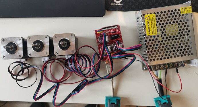

I wanted to experiment a little with MobaTools. Wired the arduino, CNC shield, drivers (I setup Vref according to tutorials), external power supply, and steppers like this:
I wrote and sent this code to the arduino:

The motors do not move at all. I don't really know where to start for investigations. Any hint?
Note: I know that with MobaTools MotorY and MotorZ are not expected to rotate sequentially contrary to what I wrote in the header of my code, but I just wanted to see things move before doing more code.
