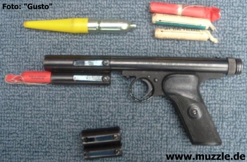

Lots of hits on DIY CO2 piercers. Boy Scouts use them in race cars. And there's this German handgun that apparently launches C02 cartridges...
Description: The “Model 101” is less a CO2 weapon than a tool for electrician work. It serves as an aid for laying electrical cables in large tube or hose systems. The pistol shoots 12 g capsules, which means: the cartridge is actually the projectile.
How it works: A tailored “Powerlet” cartridge is inserted into the tube attachment on the barrel. A thin but stable, tear-resistant line is attached to this and a plastic tip (yellow) is attached to the front. There is a holder for various linen packages under the barrel. The tethered line automatically rolls out of the packaging after the cartridge has been fired. With the help of the line, the connected cable is later pulled into the tube system.
