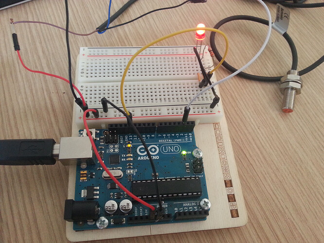

Hello, i wrote the following code but nothing, my goal is: When input pin 2 is HIGH, output pin 13 has delay 100msec and then HIGH for eg 50msec then turns LOW, when input 2 is LOW, output pin13 is LOW too.

eg for understanding, when i push and keep a button (for my case proximity sensor) delay 100msec and turn on a led for 1000msec then turn off . When release the button start again from begining.

When i push button once or hold( that's means pin 2 is HIGH) turn pin 13 HIGH for 5 sec and then turn pin 13 LOW, Could you help me with code?.
The simplest way possible, but not the best
if (digitalRead(2) == HIGH)
digitalWrite(13, HIGH);
delay(5000);
digitalWrite(13, LOW);
I try to explain better. I have a proximity sensor, gives 4.64 Volt to pin 2 if a put it near to metal. So i want a code to do this: Give voltage to pin 2 --> Delay 1sec --> LED turn ON for 5 sec and turn OFF. Once until i give voltage to pin 2 again. I hope you understand me.
Thanks
delay(5000);
Still simple. Still not the best way, but try it. You will need to set pinMode()s in setup()

When i put voltage to pin 2 led flashing. I want to work once
Then (intentionally taking you literally):
void setup(){
pinMode (13, OUTPUT);
pinMode (2, INPUT);
while (digitalRead(2) == LOW);
delay(5000);
void loop(){}
if you want it to re-arm:
void setup(){
pinMode (2, INPUT);
void loop(){
delay(5000);

Yes, i want to work once when i have pin 2 HIGH for 2 sec, then stop until i put again voltage on pin 2

The sensor is connect with pin 2 . Works if i turn ON sensor and OFF. I want to stop after 2 sec if have sensor ON. How upload video?

I have a proximity sensor for switch, connected to pin2 (black wire). When i give voltage (thats mean pin 2 is HIGH) i want pin 13 (which is connect with LED) turn in HIGH after 1sec (delay). PIN2 still has voltage but pin13 turn to LOW after 2 sec. to re arm, must be pin 2 to LOW (no voltage).

You shouldn't need to with my second example. I will double check it for a mistake, but I think it should do that. With six seconds of total delay happening after the button press, I don't see any relevance to the state of pin 2 after 2 seconds. The sequence would be in the middle of the "LED on" part at that time. Can you clarify that?
