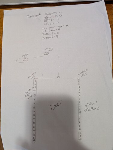

Code help for a project to raise a door with a motor
I have a project where I want a door to be raised up into the wall to create a entrance for my kid, the idea is that when they press a button (like an elevator) that the door will rise to a pre determined height reading that they Ultrasonic sensor detects and then stop the motor. and when the other button is pressed, the door will go down. I have been able to test the wiring and I have figured out the hardware side of the project but the coding side is still giving me issues.
The end goal is that the door should raise to a certain distance from the US sensor and stop but I also want to put LED's on the side that are red when the door is closed but as the door raises up the LED's turn from red to white.
My current code I have not been able to control the LED's the way I want, I found some code to have the strip one color and then as the distance on the US is reduced, the pixels go out, I like that but I want the strip to be red at max distance and then to change to white as the distance is reduced.
The other issue that I am having is the motor right now will just turn when the US sensor is detecting anything more than 76 cm, also without a button being pressed. The other thing that I believe is an issue is that I would like the motor to execute the action with only a button press and not have to hold the button.
This is the code that I have so far. Any help would be appreciated.

I suggest declaring that as "float distance" since you are using it as a float.
Also, it would be much better to structure your code as a state machine.
Did some research and, I agree, a state machine looks like it would help with that.
Your button is probably wired differently than your code expects.
Where did you find this code?
I ask also. I am at a disadvantage, but through the tiny window the code looks incoherent. The comments do not match the code, and the code doesn't look like it comes close to @littlehawn1's goals.
I don't see anything doing the "activate output 1 for 2 seconds", for example.
@littlehawn1, please start by fixing the comments so they make any sense.

In your for-loop, the variable i increases until it is the same as the variable distance. That variable could get as high as 77 or 78 or higher? But your strip has only 50 LEDs. So once distance reaches 50, the strip will be fully lit. Then the code will try to set the colour of LEDs 51, 52 etc. But those LEDs don't exist. With the Adafruit library, it will simply ignore those instructions.
So I think you need to calculate how many of the 50 LEDs you want lit depending on the distance. You are already using the ideal function for this. You use that function to calculate the value of variable red but then don't do anything with it.

there no need to have separate STOPLOWERDOOR, STOPRAISEDOOR and IDLE states
state machines are written such that each state monitors for events which require some action to be take and a change of state which then monitors for other events
look the following over.
  • i simulated your distance sensor with a simple pot
  • added prints when events occur and the distance

intelligent people ask questions
Shouldn't it be
        if (getDistance () > DistanceUp)  {
            state = S_Idle;
            doorPos = DoorUp;
            digitalWrite (PinLedUp, LedOn);
            Serial.println ("Door Up");
    case S_Lower:
        if (getDistance() < DistanceDown)  {
a7
don't understand '<=' vs '>?

Thanks, I can't but look forward to being able to read your code.
Are you getting plausible and useful data from the sensor? I'm not sure what you are measuring, is it the feedback element for knowing where the door is, informing how it should I've to be where it wants to be?
Also, does this version handle the buttons the way you want?
a7
aren't they the same thing? (do need to test for ==)
the idea of the sensor is to be placed above the door in the wall cavity and let me know how far away the door is to the sensor, so when the door raises into the wall the sensor number will get lower and lower, I plan on having the sensor 1 inch away from the top position of the door. so once the motor raises the door up and reaches that top point, the motor turns off leaving the door open. when the door is fully lowered it should be 31 inches away from the sensor (ill fiddle with the numbers once i fully build it) because the door is 30 inches high. All the sensor should be able to read is the distance that the door is from the sensor.
This version hopefully should handle what I need to do, my previous versions have fried my uno's that I had though so I am waiting for some more so I can continue with actually testing it. I feel it wasnt the code but user error that did that though, I was powering the motor with a 12v power source and had also pigtailed it to power the arduino and I believe the power was not playing nice and fried the uno, I plan on using a nano this time and powering it with a usb cable instead of the 12v power supply and then another usb for the leds since they are 5v.
