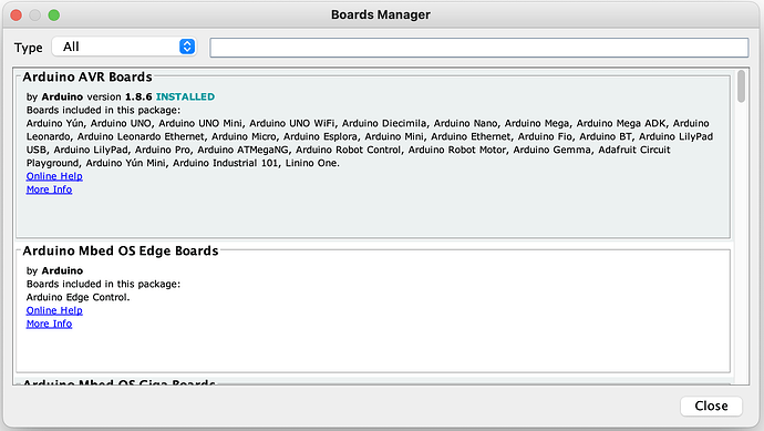

go to the board manager and see if the AVR package is installed (UI in French here but you should see something similar)
Got it updated, but still doesn't work

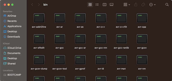

do you have something in that directory?
/Users/rahuek/Library/Arduino15/packages/arduino/tools/avr-gcc/7.3.0-atmel3.6.1-arduino7/bin
Does the path exist?
There are some things in the directory, but not the one the IDE is looking for.
