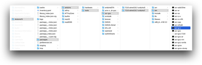

Take a look on the drive and see what is at the path mentioned.

this seems to be the right path on a Mac.
I've this in my Home/Library
can you check if you have the same?

I do not have the avr-g++ file. This must be causing my problem- How do I go about adding this file?
up to where the path works? can you show what you have?
removing the AVR package and reinstalling it should fix it.
or delete the whole Arduino15 directory and go for a full IDE reinstall, including all the platforms you want to support.
This is what I have
weird it's gone !
removing the AVR package and reinstalling it from the board menu should fix it.
