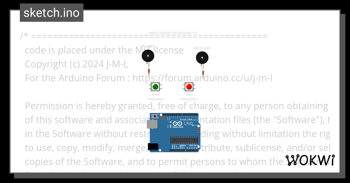

here is an example on how you could deal with it. I'm using a finite state machine to walk through the different states. (Here is a small introduction to the topic: Yet another Finite State Machine introduction)
you can try the code here
you start a session by clicking one of the button, the number of steps per possibility is set in
constexpr size_t stepCountPerStimulus = 3; // change to 30 if you want 30 x 4 steps in the sequence
I used 3 to make it short to test (12 stimuli).
once you are done you get a report formatted for the forum, it looks like this

I replaced the motors by two buzzers but you can use your motors (just need to modify the startAction() and stopAction() functions)
click to see the code

  uint32_t reactionTime;
constexpr size_t sequenceLength = 4 * stepCountPerStimulus;
Step sequence[sequenceLength];    // 840 bytes
size_t sequencePosition;
uint32_t startTime;
void fisherYatesShuffle(Step arr[], size_t size) {
  for (size_t i = size - 1; i > 0; --i) {
    size_t j = random(i + 1);
    Step temp = arr[i];
    arr[i] = arr[j];
    arr[j] = temp;
void generateReport() {
  Serial.println(F("|Trial|Location|Prompt|Answer|Reaction time(ms)|Delay(ms)|"));
  Serial.println(F("|-|-|-|-|-|-|"));
  for (size_t i = 0; i < sequenceLength; i++) {
    Serial.write('|'); Serial.print(i + 1);
    Serial.write('|'); Serial.print(sequence[i].location == LEFT_ARM ? F("Left") : F("Right"));
    Serial.write('|'); Serial.print(sequence[i].frequency == LOW_FREQ ? F("Low") : F("High"));
    Serial.write('|'); Serial.print(sequence[i].response == LOW_FREQ_BUTTON ? F("Low") : F("High"));
    Serial.write('|'); Serial.print(sequence[i].reactionTime);
    Serial.write('|'); Serial.print(sequence[i].initialDelay);
    Serial.println('|');
  Serial.println();
void generateSequence() {
  // initialize the array
  randomSeed(analogRead(A0));
    if (i >= 3 *  stepCountPerStimulus) {
      sequence[i].location = LEFT_ARM;
      sequence[i].frequency = LOW_FREQ;
    else if (i >= 2 * stepCountPerStimulus) {
      sequence[i].frequency = HIGH_FREQ;
    else if (i >= stepCountPerStimulus) {
      sequence[i].location = RIGHT_ARM;
    else {
    sequence[i].initialDelay = random(minDelay, maxDelay + 1);
    sequence[i].response = NO_RESPONSE;
    sequence[i].reactionTime = 0;
  // shuffle the array
  fisherYatesShuffle(sequence, sequenceLength);
void startAction(byte loc, byte freq) {
  byte buzzerPin = (loc == LEFT_ARM) ? leftArmBuzzerPin : rightArmBuzzerPin;
  unsigned int frequency = (freq == LOW_FREQ) ? lowFrequency : highFrequency;
  tone(buzzerPin, frequency);
void stopAction(byte loc, byte freq) {
  noTone(buzzerPin);
  highFreqButton.begin(highFreqButtonPin);
  lowFreqButton.begin(lowFreqButtonPin);
  pinMode(rightArmBuzzerPin, OUTPUT);
  pinMode(leftArmBuzzerPin, OUTPUT);
  Serial.println(F("➜ Press a button to get started."));
  highFreqButton.poll();
  lowFreqButton.poll();
  switch (state) {
    case IDLE:
      if (highFreqButton.onPress() || lowFreqButton.onPress()) {
        // one of the two button is pressed, we start
        generateSequence();
        sequencePosition = 0;
        startTime = millis();
        state = DELAY;
    case DELAY:
      if (millis() - startTime >= sequence[sequencePosition].initialDelay) {
        // we waited long enough, action
        startAction(sequence[sequencePosition].location, sequence[sequencePosition].frequency);
        state = ACTION;
    case ACTION:
      if (highFreqButton.onPress()) {
        sequence[sequencePosition].reactionTime = millis() -  startTime;
        sequence[sequencePosition].response = HIGH_FREQ_BUTTON;
        state = NEXT;
      else if (lowFreqButton.onPress()) {
        sequence[sequencePosition].response = LOW_FREQ_BUTTON;
        state = NEXT;
    case NEXT:
      stopAction(sequence[sequencePosition].location, sequence[sequencePosition].frequency);
      sequencePosition++;
      if (sequencePosition >= sequenceLength) {
        state = SEQUENCE_TERMINATED;
        state = DELAY;
    case SEQUENCE_TERMINATED:
      generateReport();
      state = IDLE;
      Serial.println(F("➜ Press a button to start a new session."));
hope this helps
