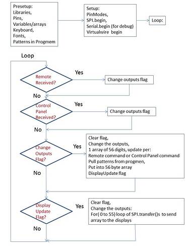

For example, here is one I did in powerpoint for updating a display, using the Save As feature to make a .jpg for displaying here.
You can make it as thorough as you like.
For example, I will likely add to this as my hardware design has changed from a discrete shift register per display to a multiplexed approach, so I will add a check for the time every mS or so, and loop thru driving the anode pattern and pulling the appropriate cathode low.
