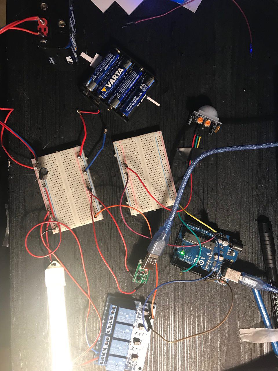

hi guys i have a problem to understand with my project in the picture .++
is a PIR sensor connected with is out strictly to the pin 3 , this one send his statement to 13 . it is connected to the relais board of 5 v a light saber of 36 led 12v is linked in ! then the problem is when the pir sensor detect a movement it turns off the lamp in stead of turn on ! no movement must to means no light !
the code is below i try to change at the end high to low but doesnt work
THX IN ADVANCE

I would use this
if (__>__)
 ____
else ()
____
see if that format works
I would add some more ( ) in this line to ensure it compiles as intended:
if(!lockLow && millis() - lowIn > pause){
change to:
if(!lockLow && ((millis() - lowIn) > pause)){
