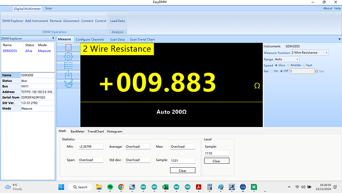

I've just done a test using an arduino Uno R3 and Sterretje's schematic from post #2, and got good results.

    resistance = (50.0 * raw)/(1024.0 - raw);
    Serial.print("Resistance = ");
    Serial.print(resistance);
    Serial.println("Ω");
    Serial.println("");
The Arduino measures the resistance as 9.81Ω:
And here's what my multimeter said:
