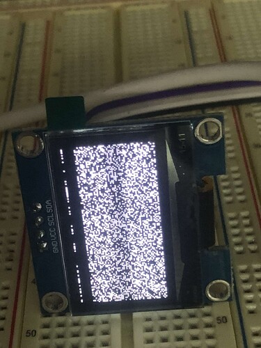

#include <Adafruit_GFX.h>
#include <Adafruit_SSD1306.h>
#define SCREEN_WIDTH 128
#define SCREEN_HEIGHT 64
#define OLED_RESET -1
#define I2C_ADDRESS 0x3C
Adafruit_SSD1306 display(SCREEN_WIDTH, SCREEN_HEIGHT, &Wire, OLED_RESET);
Wire.begin(D2, D1);
if (!display.begin(SSD1306_SWITCHCAPVCC, I2C_ADDRESS)) {
Serial.println(F("OLED ไม่พร้อมทำงาน!"));
for (;;);
display.clearDisplay();
display.setTextSize(1);
display.setTextColor(WHITE);
display.setCursor(0, 0);
display.print(F("Hello, World!"));
display.display();
Selecting the correct library usually the solution. Your OLED might not have the hardware for SH1306. Show a good picture of the components on the reverse side.
That screen pattern is what you get when you use a SSD1306 library with an SH1106G controller. Use the proper library.
