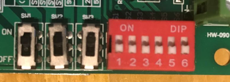

Now the driver I'll be using it's a TB6560
I understand the wiring on the left, the setting on the MS1, MS2 MS3 and DP 1,2,3,4,5,6.
Now on the right there are 6pins:
EN- ; EN+, CW-; CW+; CLK -;CLK+
Should this be the wiring for my case (Arduino UNO- TB6560):
Pin 2 ---> CLK+
Pin 3 --> CW+
Pin 4 --> ?
Pin 5 --> ?
Pin 6 --> EN+
I have MS1 and MS2 buttons? are they replaced? am i missing something?
Do i need to use Pins 4,and 5 from the Arduino?
This page shows the wiring for a TB6560. Note that the inputs to the driver are optoisolated. Step, dir and enable have 2 pins each. One for the anode of the optoisolator LED and the other for the cathode. In the drawing on the linked page, all of the cathodes (step -, dir - and enable -) are wired to ground. Step +, dir + and enable + are wired to their respective Arduino outputs.
The microstepping (MS1 and MS2) is set with the dip switches and cannot be controlled by the processor (Arduino) so there are no outputs to MS1 and MS2.

Thank you,
I'm going to have a look at it and see if I can get my problem running, changing that potentiometer for an analog stick. I'll let you know how it goes
So I finally made it work (at least it moves) at about 120 RPM
The code I'm using is this one :

I'm attaching for those of you who'd like to know some pics of the TB5869 config, and a little video of the motor running with the joystick
