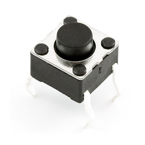

The one I have is just a simple push button like this one.

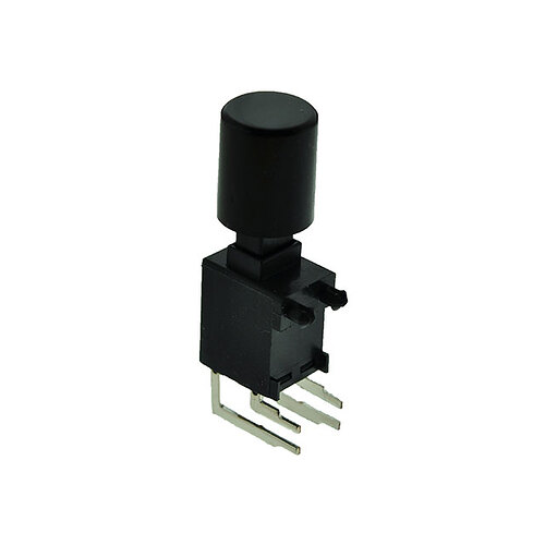

The plan is to actually use a DPST switch that self-latches like this one.

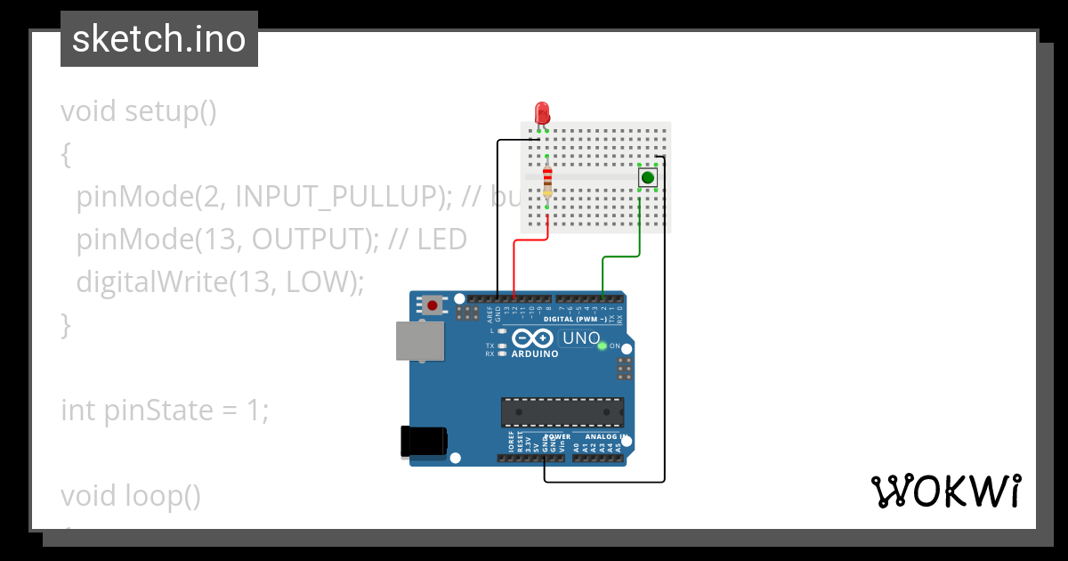

I do not understand what you are seeing. Comments are on the right.
I have made some changes to your code (button wiring, missing pair of brackets). Tried not to change it too much. Only a button press is needed now.
Take a look if this is what you wanted:
There's room for improvements.
there's nothing to do until the timer expires
