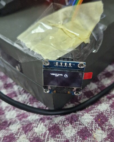

I'm trying to make replacement display for my coffee machine using Arduino. Original display was simple 59x12 pixels LED matrix controlled by 9 74HC595 shift registers. LED matrix went defective and I'm trying to make some emulator that can use OLED display for it.
Protocol is pretty simple, there are 3 pins, CLOCK, DATA, LOAD, LAST_COLUMN. Display shows one row at the time after LOAD pin is pulled to HIGH.
First 12 cycles of clock dictates the row to be shown, second 58 cycles dictates the data on that row, and last pixel on the row is lit up when LAST_COLUMN is high (that pin is not necessary since it's on very rarely). Clock is about 80 kHz, with pauses of 600uS between column data burst. (So, 70 clock pulses, 600uS pause). Since data transfer to OLED via I2C is a lot slower than 600uS, I'm dropping some frames because I can live with that. I hacked up some first version of the code, (I'm planning to send 8xRow to display once I got everything working up, and some other optimizations), which works for few seconds and then it stops. The problem is the slowness of the pin pooling which ultimately leads to de-synchronization. Do you have some idea what can be sped up here, or should I use another micro (prototyping on UNO, will put the micro in machine once everything is done). Perhaps, I should turn off the interrupts, since timer interrupt will happen once in a while. I'm reading the pin state from PORB register instead of in interrupt since for that frequency, I think the interrupt will behave more erratically.
Time between two clock pulses is 6uS, so code in state2() function should take less time than that (I don't have any profiling tools to see the actual speed, perhaps I should count machine instructions and check the manual for avr to see cycle count for each of them in that routine).
I've inlined all functions in order to not introduce the function calling overhead (put the parameters on stack, long jump, function exec, popping return address, putting result on stack, etc.)

Code with ISR had some drawbacks, it's sadly not fast enough so I needed more optimization in the tight-loop pin polling approach. This is more robust version of the code, next step is display scaling and memory optimization. I'll post new findings and eventual questions. If anybody needs it, this is for Jura J7 machine.
