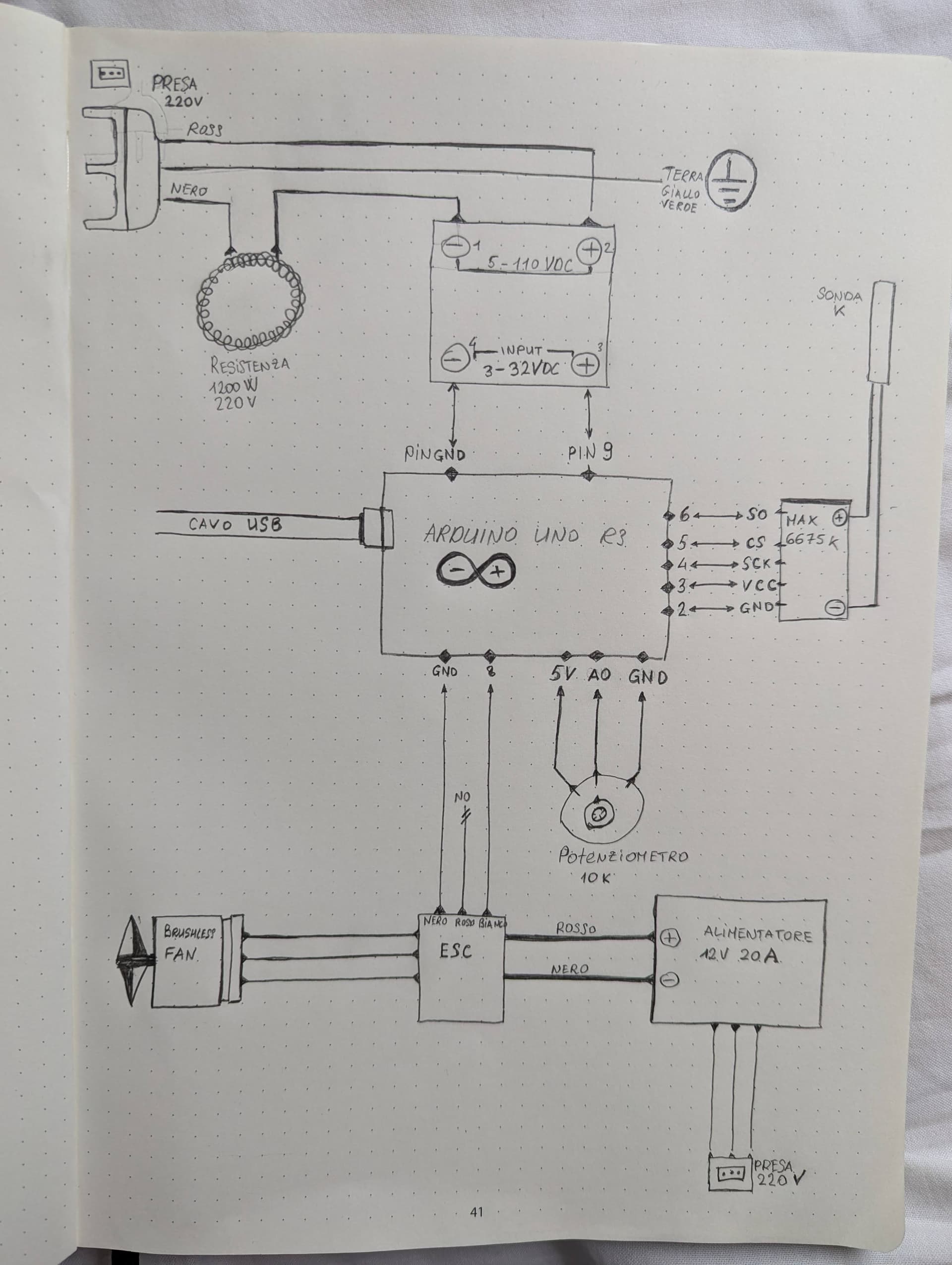

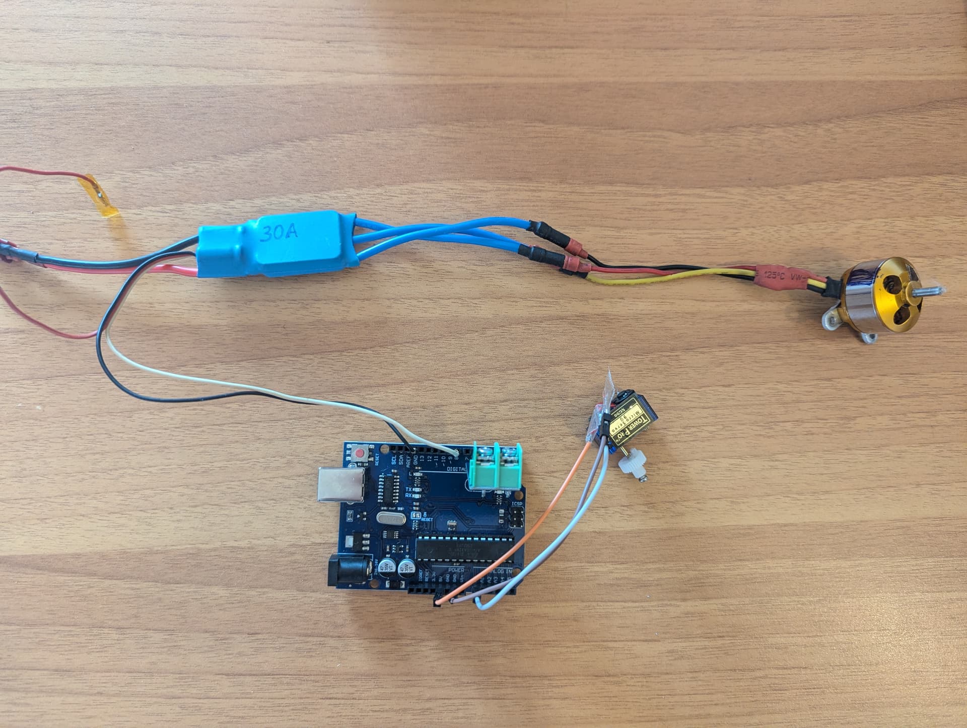

good morning everyone, for a few days I've been trying to create a coffee roaster from a popcorn machine and control it with Artisan Scope. These will be the components:
  • PopCorn Machine 1200W - 220V
  • Arduino Uno R3
  • MAX 6675 K
  • SSR 40A - 220V
  • Brushless ESC - 30A
  • Brushless FAN (2200kv - 12V which is used in RC Airplanes)
    On the web I found a code that allows me to see the temperature with Artisan and manage the heating resistance with the SSR relay.
    Later I added another code to control the fan but only with a 10K potentiometer.
    My request is the following, what code do I have to add to also manage the Brushless Fan from Artisan? I opted for a brushless motor because I used to do model airplanes and therefore I have it available and also because it has much more power than the brushed motor.
    I attach some photos.

Is the motor controller waiting for PWM or just HIGH/LOW? If PWM, put the white wire on a PWM pin, labeled with a tilde/squiggly.
Again, if PWM, find a sketch to "fade" an LED to practice PWM control.
Thanks for the tip, tomorrow I will try again and I'll let you know how it went. Meanwhile, this evening I try to study the programming language. My big difficulty is programming on Arduino and then configuring Artisan to recognize everything😅
Unfortunately my inability to program arduino, forced me to buy a TC4+ board, in theory this will be able to control both the brushless motor and the SSR relay directly from Artisan Scope. I'll wait for it to arrive.
While you're at it, consider getting a copy of the Arduino Cookbook and while going through it cover to cover. Try out any projects that catch your interest.
