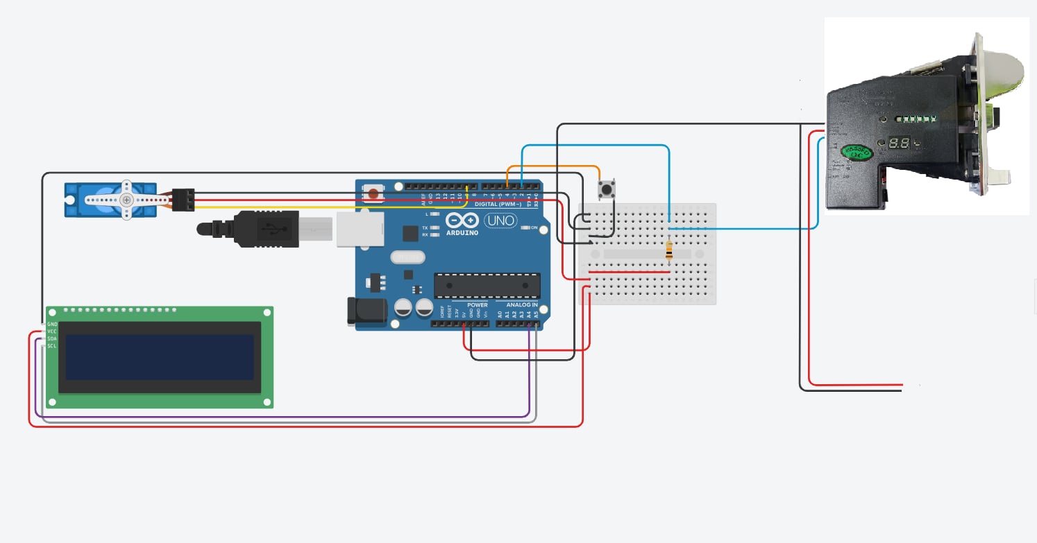

Hi, im building a cigar vendo however when im about to insert a coin and it makes contact on the surface of coin acceptor cover, it's giving a false pulse. It does it when Im not touching the actual vending cointainer, but when im touching the container itself it works fine. It fixes the issue if i attach a grounding wire, I dont want to keep the grounding wire just to make it work. What can I do?
Im using a ground bus for common ground,
-(disregard servo wire connection from image. Currently using 5v separate power supply for it)
What's wrong with the grounding wire?
Where is that wire in the picture?
Give the servo an extternal power supply. Controllers are designed to supply power.
Seems like we already went through this with your other topic for this coin acceptor.
Unfortunately it comes and go. Maybe when i thought it was working already. I was holding the container while inserting the coins
What do you mean by "bus"
I thought you soldered everything together but you still show a solderless breadboard.
Post your code

not really into electronics, please bear with my diagram
Sounds like it may be a static electricity problem. I suggest you keep the ground wire connected. The ground wire provides a path for the static electricity so that it does not create a pulse. You may also try decreasing the 10K pullup to maybe 3.3K
IINM, it seems like the cover is floating, which can of course create mishaps like that. did you check that the cover is grounded from the accepter ground?
all modules are in the common ground, If I add extra wire from ground to earth, it works fine, without it, it gives false pulse.
ooh it's 220V then
the cover is plastic, I dont see any reason why it should be grounded
it is plastic? hmmm
those three dc's are connected in a one 3 gang outlet to 220v
could you specify what dcs or 3 gang means? excuse my bad english (i'm turkish)
yes it is
I dont know the global term too, but locally we call it that way,
dc adapters, and 3 gang outlet,where you can technically plug 3 different devices
See post #10
If it looks like this, then it is metalized plastic.
10k is what most people with the same projects recommend, but I'll try to lower the resistance and see if it works
It will help increase the noise immunity and make it harder for static to generate a pulse.
