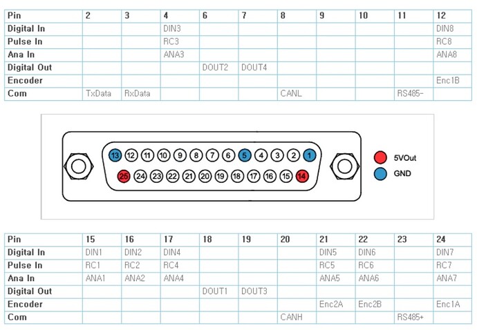

This is the pinout from my dual motor controller.
Thank you so much.
I'm going to need more data on that "Dual Motor Controller". I don't understand why it has 8 inputs (choice of 'digital', 'pulse', or 'analog'?) and 4 'digital' outputs.
Without additional hardware, I think you will be using the TxData and RxData communication pins. You will need the documentation for that protocol. The protocol manual should allow you to control your motors.

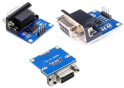

Is this type ok?

Since you aren't plugging into a 9-pin Serial port on an old PC you might be better served by an adapter that doesn't have the 9-pin Serial connector.

I could find these two types without the 9 pin serial connector.
Could you tell me which type I should get?
hi sorry to intrude but Mr Wasser I'm working on an Arduino Project which concerns A SIM 900 GSM module I looked at that discussion and couldn't reply to it and so I am asking it here here is a screen shot of my dilemma
After reading the specifications the only difference seems to be operating temperature range. CSE: 0-70°C, ESE: -40-85°C. Either one should work. Those don't have. manufacturer's logo (Maxim/AnalogDevices) so they are probably clones and who knows if the operating temperature ratings are valid.
