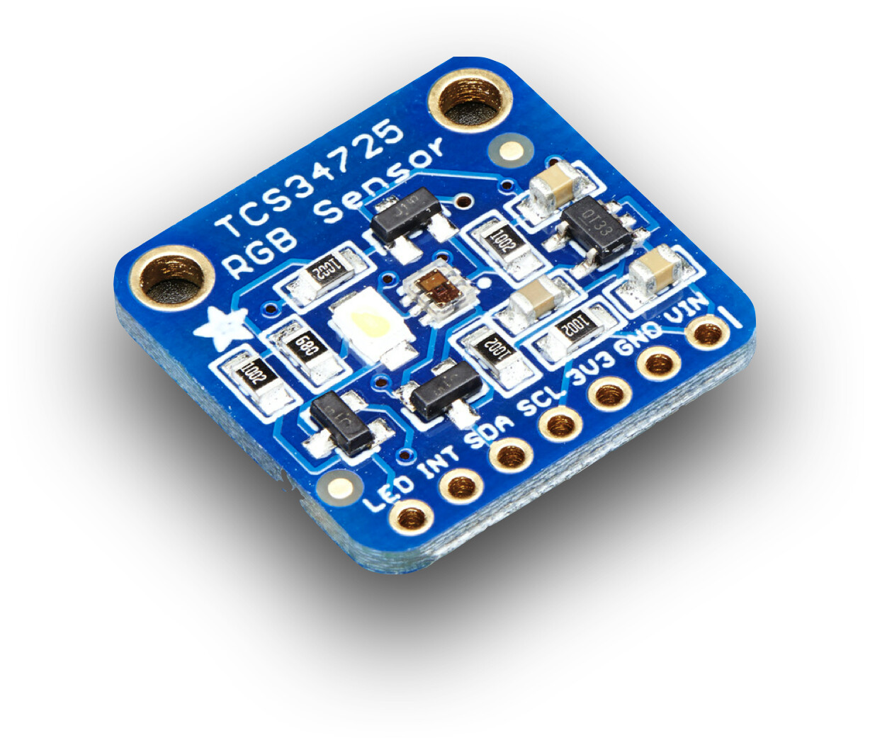

i am planning to connect the color sensor adafruit TCS34725 (https://eu.mouser.com/datasheet/2/737/TCS34725-932784.pdf) to my arduino micro and i would like to transform the captured data into midi CC messages. So this thing should act like a MIDI-USB Device.
First i have a question about the wiring:
Here are my connections:
VIN to 5V
Gnd to Gnd
SDA to 2
SCL to 3
Is this correct? Here is a link to my arduino board pdf: https://content.arduino.cc/assets/Pinout-Micro_latest.pdf
Later i would like to include buttons and potentiometers, but i thought, at first i need to make this work. So i first just try to get Data from the Sensor.

But i dont get any data. Any idea why?
I know this code was initially written for Arduino uno. And i found out (but also not sure), that this wire.h library is not for micro boards. Is that the problem? And how can i solve this?
