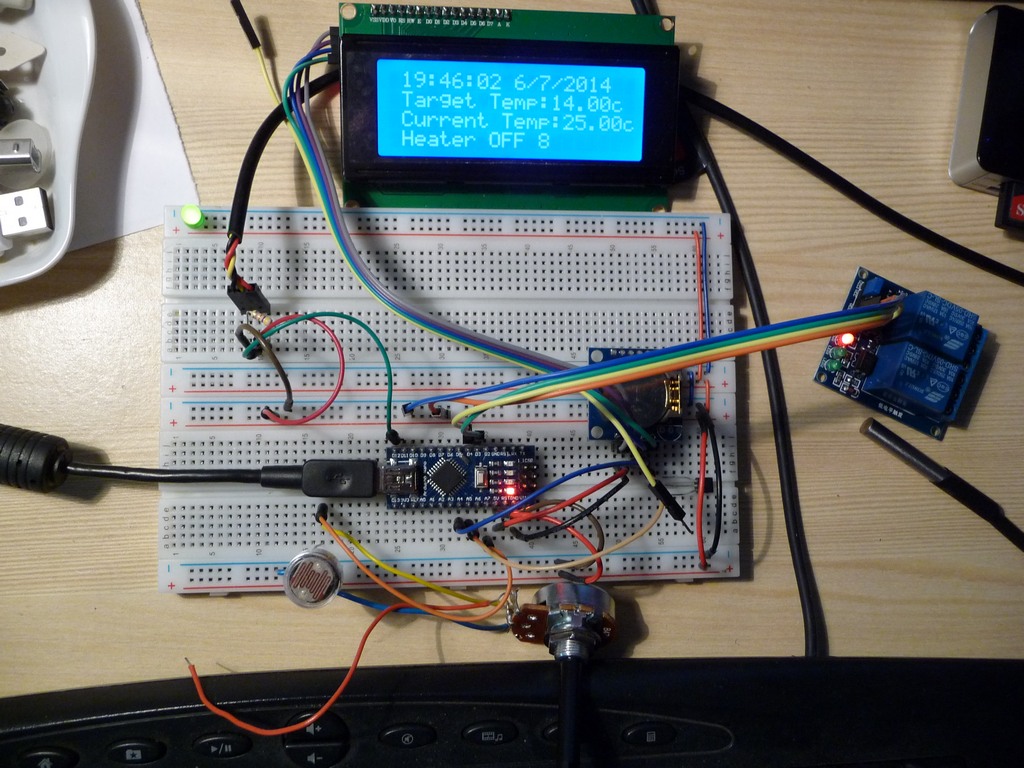

Hi All,
Well I've been playing with the Arduino for sometime now, BUT still struggling with C and coding. I have built a controller for my seed propagator, which is basicly a DS1307 and DS18B20 with an output to a relay.
Some of this code is mine but other parts from forums and the net. It all works fine, but the code to get the temp is a bit long winded and I can't quite get my head around it. But I found something much simpler using the DallasTemperture library! What I would like to do is get rid of the complicated? stuff and add this simpler code, but I try putting the various #include and #define at the top of the code, but then there's lots of compiling errors, etc..
Here's my? code that works.

I'd like to get rid of the function GetTemp and replace it with this.
#include <OneWire.h>
// Data wire is plugged into pin 12 on the Arduino
#define ONE_WIRE_BUS 12
// Setup a oneWire instance to communicate with any OneWire devices (not just Maxim/Dallas temperature ICs)
OneWire oneWire(ONE_WIRE_BUS);
// Pass our oneWire reference to Dallas Temperature.
void setup(void)
// start serial port
//Serial.println("Dallas Temperature IC Control Library Demo");
// Start up the library
sensors.begin(); // IC Default 9 bit. If you have troubles consider upping it 12. Ups the delay giving the IC more time to process the temperature measurement
void loop(void)
// call sensors.requestTemperatures() to issue a global temperature
// request to all devices on the bus
sensors.requestTemperatures(); // Send the command to get temperatures
Serial.print(sensors.getTempCByIndex(0)); // Why "byIndex"? You can have more than one IC on the same bus. 0 refers to the first IC on the wire
Serial.print("  ");
Also how do I change- Serial.print(sensors.getTempCByIndex(0)) to something like TEMP=sensors.getTemp(0) to output to an LCD.
Hope someone can help or point me in the right direction..
Thanks and regards
Mel.

Well, well that's very disappointing, come on chaps! I'm not asking anyone to rewrite the code, it don't need that!! I did hope that someone in the know might just give a hand or something... Is'nt that the idea of forums! that we help and share our ideas, etc...
I'm sure michinyon knows how to do it, but perhaps he wants to keep it to himself.........
But all's well because I did it myself, just looked at it, and logically moved the code sections to where I thought they should go and here's my new code, fully working.

Hi All,
Sorry I was not trying to blame anyone! but perhaps the frustration got to me. I've seen some very stupid questions on this forum, but they usually get some kind of response, which might include, go read a book. I just thought someone might come up with something a bit more constructive or an idea or 2. Perhaps I didn't make myself clear, suppose it always sounds OK to the writer.
In the end perhaps the lack of an answer was the best lesson, as I had no alternative but work it out for myself, and sure I learnt something!!
While my C skills may not be that good, I've been into electronics for many years, before the Arduino I used the Picaxe with a poor simple basic, this didn't lead to good programming practice, also a bit of Z80 asm many years ago.
I do try and help others out where I can......
Here's a picture of the seed propagator project working. Or is that the project working on a breadboard, make the PCB next I think.
Regards
Mel.
