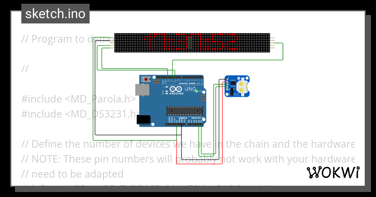

Combine hours, minutes and seconds to output
Using MD MAX and Parola libraries. I'm trying to make a clock using max7219 and 8x8 leds.
I start with minimal print example and ad RTC. I can display hours, minutes and seconds as their own, but trying to make hh:mm:ss display they just group and stack to the left corner. :smiley:
Any ideas how to display them in row instead on top of each other?
Code:

sounds like you need to advance the caret (ie, the place at which the next print will start) after each print?

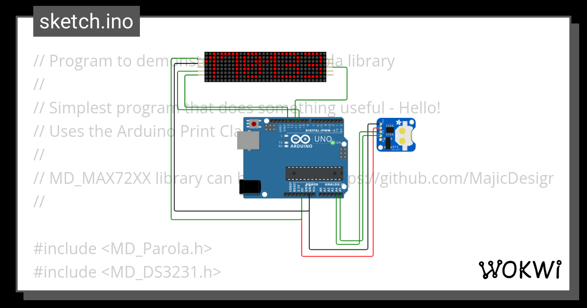

You can try this:

char buf[20];
void loop(void)
 RTC.readTime();
 sprintf(buf,"%02d%02d%02d",RTC.h, RTC.m,RTC.s);
 P.print(buf);
On Wokwi it looks like this:
Be aware that the sketch on Wokwi is different to your version due to the available simulation components ...!!!
Good luck!

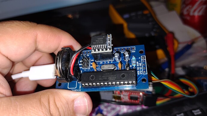

Thank you, already playing with it and got "seconds" running. :smiley:
Currently i have 1X4 grid, but I'm drawing a custom PCB with easyeda.
Youtube how that clock turned out:
What caused the colon to stop blinking momentarily 5 seconds into the video? Was that intentional?

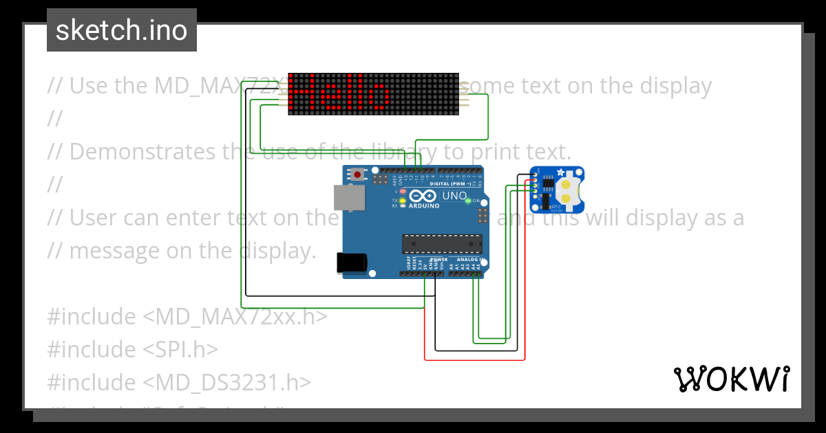

here is a demo-code that uses a different library
// Use the MD_MAX72XX library to Print some text on the display
// Demonstrates the use of the library to print text.
// User can enter text on the serial monitor and this will display as a
// message on the display.

  Serial.print("\n[MD_MAX72XX Message Display]\nType a message for the display\nEnd message line with a newline");
    myMessage_SS = "Hello";
    //PRINT(myMessage_SS,"1");
    printText(0, MAX_DEVICES-1, myMessage_SS.c_str());
    //PRINT(myMessage_SS,"2");
    myMessage_SS = "World";
    RTC.readTime();
    myMessage_SS  = RTC.h;
    myMessage_SS += ":";
    myMessage_SS += RTC.m;

bad power connection. I made a custom UNO board and at the moment of filming it was powered through ICSP header with loose jumper wires from programmer. It has "raspberry pi" DS3231 RTC Either on pins or soldered directly, and CR2032 holder soldered on PCB to keep clock running.
Also has RX/TX pins and other pins available, but mostly why i made this was that i needed a board that can be screwed behind these 1X4 matrices.
Changed it to USB-C power and now running just fine. (C used only for power)
First prototype..
Might need to reduce brightness for convenience, but MD libraries has that built in.
